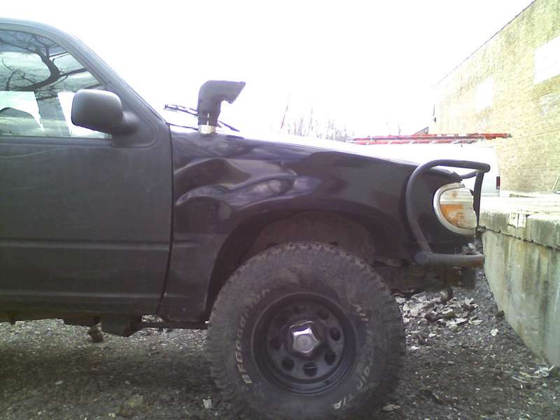

snorkel
i also need to know if the is a snorkel kit for the explorers.
Snorkles are stupid. You won't take your explorer through a five foot deep river anyway so don't gay it up. If you really want to look like a retard go to home depot and get some ABS pipe and joints and make one up.

There are no snorkel kits for the explorer. Everyone on here with a snorkel is custom.
If i am in water deep enough to come up to my snorkel, i have more to worry about than sucking water into my intake. having a snorkel that goes to the roof is quiet unnecessary. These are 4x4 trucks, not submarines.
