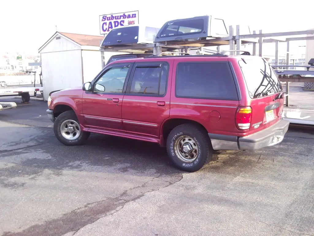

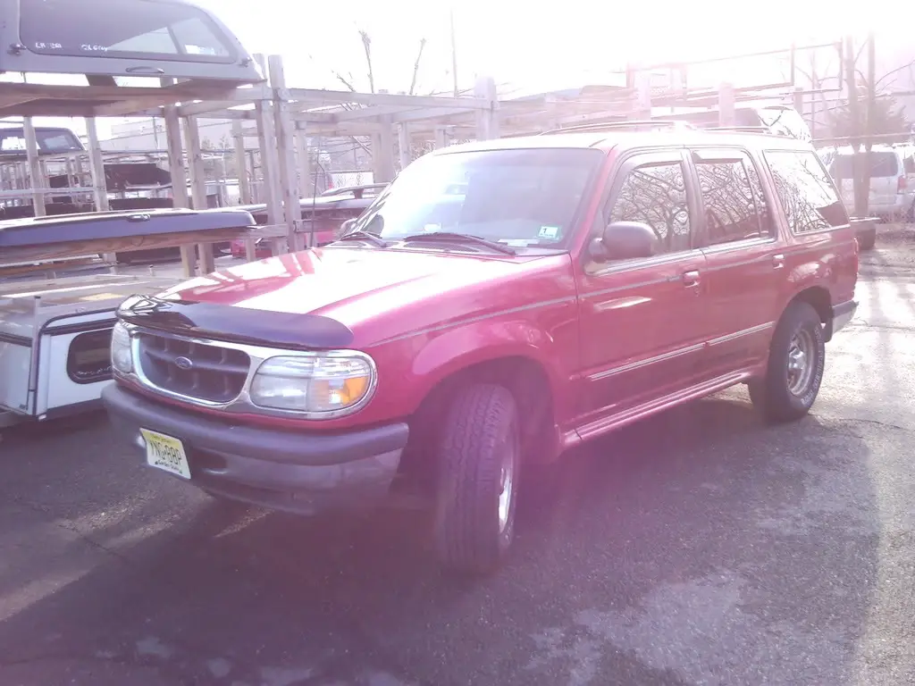

Hello i finally got my 98 Xlt V6 Sohc about a week ago. This is gonna be mainly my daily driver, but if i can i want to be able to tow my 91 jeep Cherokee maybe once a month to go wheeling. Now I actually have to go get it weighed but its probably in the 3500-4000 pound range(and i know i have to figure on a trailer to) i am gonna go with a draw-tite max frame hitch I'm thinking the square tube it give a little more weight capacity with a w.d. kit. I'm also gonna do electric brakes and i want to upgrade the vehicles brakes what else do you guys recommend.
here some pics so you can see what im gonna be using
