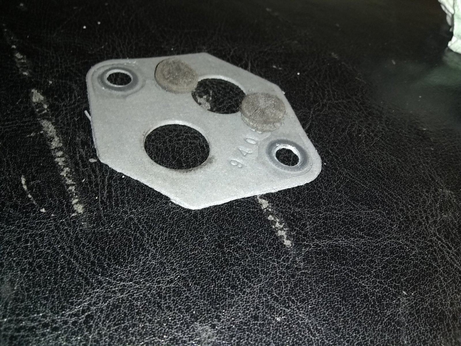

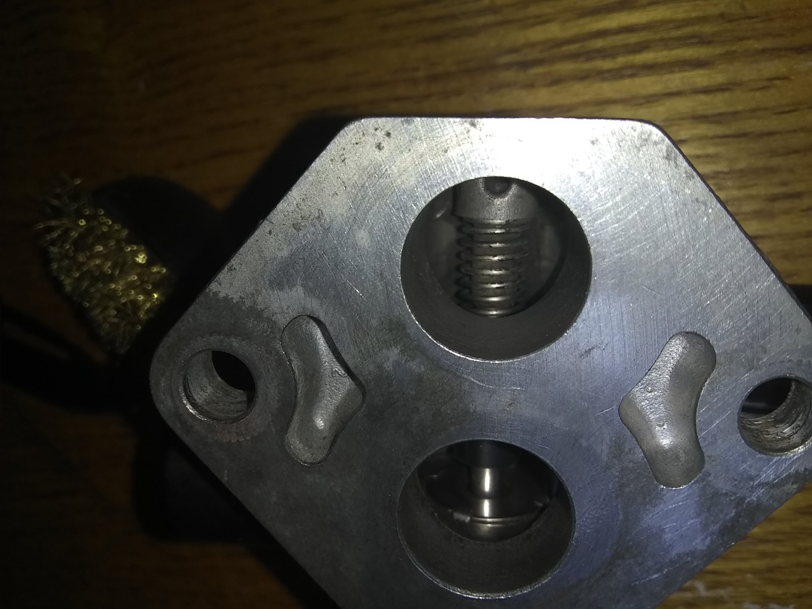

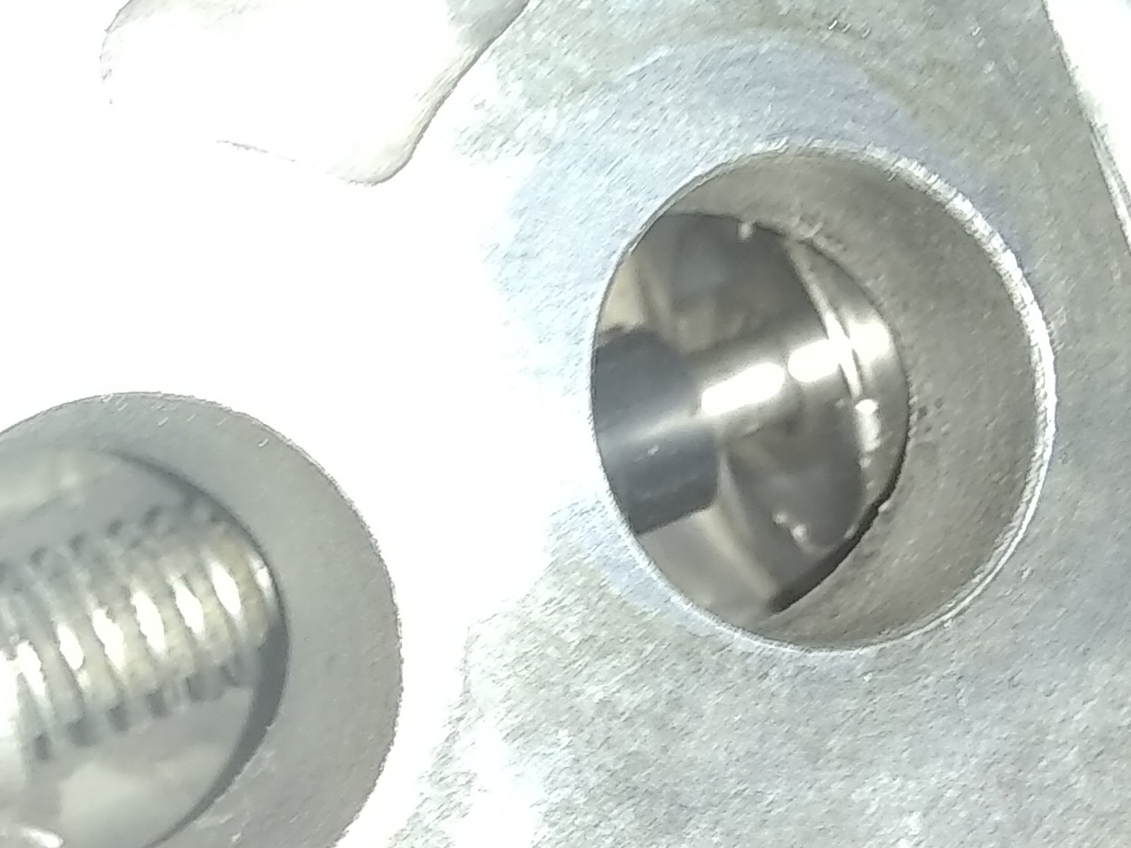

I recently just bought this 1997 Ford Explorer 2 door Sport Trac 4.0 liter SOHC, when I start the vehicle in the morning cold start it's like it's hunting for the position were supposed to be idling at it'll do it probably four or five times and then finally find the spot where it's supposed to be. Then it'll be fine until I warm the engine out and then sometimes if it's acting right it'll idle perfect at 650 or 700 and then it'll drop to five so I put it in drive and I can drive it just fine as long as I'm holding the gas pedal if I sit too long at idle eventually it will stall out, I've also had it died at a light not an exit ramp though, I've read the forums Googled a lot of things I took the IAC off cleaned it thoroughly it was really dirty I took them MAF off cleaned it thoroughly I also clean the throttle plate there's still a little bit of Gunk around the edge of the plate that needs to be kind of scraped off instead of wiped off that I couldn't get it does run better after the cleaning and I reset the computer by unhooking the negative wire on the battery terminal and then I ran alligator clip from the positive to that disconnected negative and let it sit for 10 to 15 minutes. It only does this sometimes not every time and I do not get any check engine light none no lean codes no codes at all I checked all the vacuum hoses they all look in good condition the only thing I have not done is actually remove the PCV valve and check it but it is plastic and it does look original. Without any codes though I have no idea what it is. Somewhere I read that the idle air control valve if it goes out we're starting to go out it will not produce a code I just want to double-check I have a meter I'm thinking about testing the throttle position sensor cleaning the rest of the gunk off the plate and maybe hitting it with some seafoam I don't know what else to do and this is really important it idles better when the heater is off once I turn the heater on I get a clicking noise it'll click one time and the RPMs fluctuate and then it'll set in it'll click every time while the rpm is hunting. It doesn't do that all the time either but while I was hunting with the heater on it'll only hunt from at idle in park from like 5 400 2 650 or 7 but it will pulse it pulsates.
