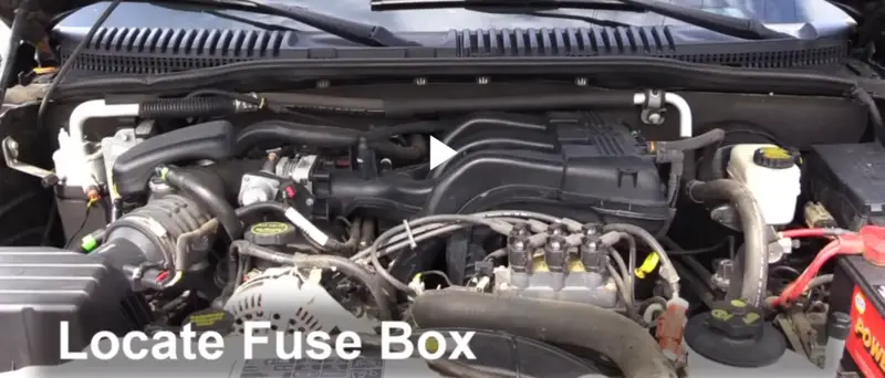

Looks like the CEL is staying on while cranking. There should be a code I believe. if not, disconnect the fuel line and see if you are getting fuel to the engine. Just put a gauge or if you don't have one, put the end in an empty bottle and crank.
Hello my friend.
Could you please tell me how i can locate fuel line from the engine connectors (or you mean the one after the fuel filter under the car). I can't know where is it (You can mark to me on the image).

It should be on the drivers side under the intake manifold.
CEL = Check Engine Light
I am more familiar with my v8 but I would imagine the fuel supply line comes on the same side, which is the driver side and then there is a crossover tube under the manifold to the passenger side injectors.
Watch some of the youtubes videos with keywords "Ford 4.0 SOHC fuel" like this one.
Any video involving an Explorer from 02-10 with the 4.0 should be similar.
