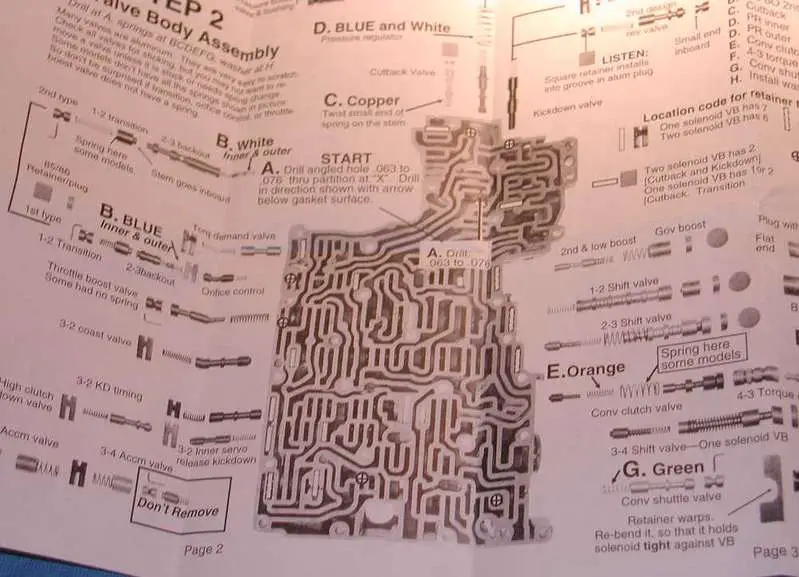

Hey folks. Some where out there, I hope, I can find a diagram/schematic for the fluid passage flows for my 5r55e valvebody.. I'm having an issue with mine. Cold I have proper shifting..although it has always been slow to go from park into gear, once in gear it shifts normally. OD light flashed the other day. But before I could pull the code, it went away. Now, when warm/hot it requires atleast 1000-1200 rpm to engage in gear. Any gear. All the same. But has huge shift flare 1-2. And slipping a little bit. Yes fluids are topped up and fresh. Any ideas? But still I am looking for this diagram for reference. Help(?)
Your thread was moved into the transmission section. Check the 5R55E valve body rebuilding diary sticky thread on the top of this section for more information. This photo was taken from Glacier991's photo gallery:

Thank yu much Brooklynbay for the quick reply, but moreso I am looking to trace where all the worm passages go to n fro. I would love to figure out if I'm crazy to think that somehow the pressure coming directly from the pump/tc is Geting leaked away when hot, before it reaches it's intended locations... Ya know what's I means? Thx for the help so far :):):)

There is no oil flow chart that I know of. You need to do a line pressure test to check the pump.
