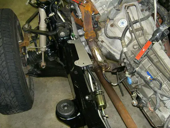

Hey buddy, got a question on that 5R55E tranny. I had posted a few pictures in another thread but I'll ask again as it sounds like you know what our doing. The old transmission had a 90 degree vent tube ontop near the back and there is a rubber line and metal line that wrapped around and drains to the left of the transmission. Quite long actually. The new transmission has a different vent tube with a square dangling cap. I called Powertrain products about it and they said it was a revision some time back. So my question is if the old 90 elbow vent had such a long drain line, will this one with no drain tube connection leak fluid all over the rear end of the transmission at times? I popped off the square cap and looks like there is a thin plastic plunger of sort inside the tube. I'm guessing I can discard the old drain tube and leave as is. Please see the pictures. Thanks!

The longer vent system is better because it prevents more from getting in, like being submerged that far. I don't know when the changes happened or why some have the simple vent, I guessed that it was for 4WD models, the long vent.
both vents will work
I prefer the rubber line, it vents up higher
