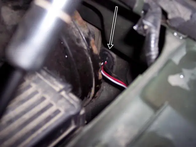

first off hello every one im andrew but to my question if any 1 has a system in there truck my question is were did you run ur power wire at on the fire wall i have a 2004 mountaineer v8 and cant find a place at all my buddy has a 04 explorer witch is a v6 and he did his right behind his brake booster but mine seems to be back farther then his and no room to do it i dont wanna door jam it but i cant find a spot any suggestions?
Drill a hole and get a rubber grommet for the wire
there is an existing hole covered by a gromet down behind the brake booster on the drivers side that enters behind the brake pedal. you will have to peel back the floor covering to see the gromet from the inside. just put a slit in it with a knife and pass the wire through. see pictures for reference
thanks kazer im probably gonna have to do 4 gauge instead of 0 to get behind that but i woulda never guessed that was there..lol
