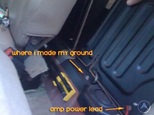

After this, I just released all the plastic door guards and tucked the power cable up underneath the carpet all the way back to the rear seat.

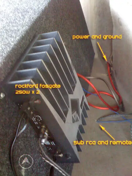

In the picture above, you can see where I brought my Power lead and Ground through to the cargo area. I connected the ground to one of the bolts underneath the rear seat flap. If sanded down real quick, it makes a great secure spot for your ground.

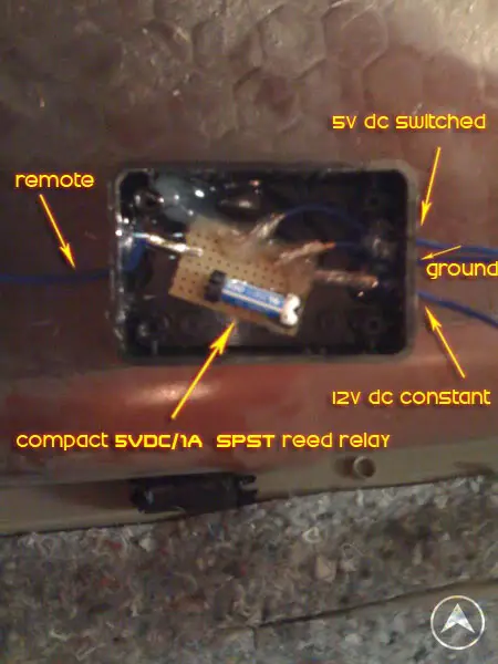

Now for the Remote cable, to power on the amp. One would think that the stock amp would have a remote as well. Well it does, but it's only 5.5V. Most aftermarket Amps will need 12V to recognize it's time to turn on. So after taking my multimeter to the wires, I found that the stock amp has a 12V constant power, and a 5.5V switched power. (Other threads in this forum have brought up this issue, I'll work on linking to those threads.)
So here's my solution:
What you're looking at is a Compact 5VDC/1A SPST Reed Relay. By connecting the highlighted leads to the necessary wires, I now have 12V switched power! The concept here is fairly simple: when the relay sees 5V, it flips a magnetic switch and connects my 12V to my remote. This part can be purchased for $2.99 at RadioShack, along with the little black case it's in and the waferboard to connect it all.

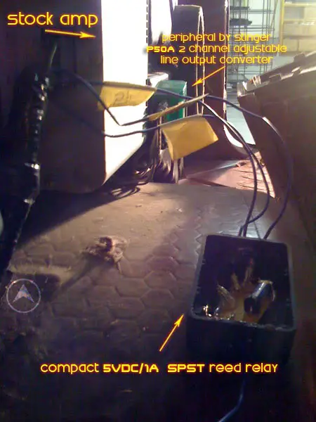

Here you see where the P50A 2 Channel Adjustable Line Output Converter comes into play. I decided to tap into the sub signal after the amp.

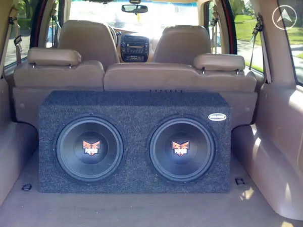

And there you have it! With this guide, you can install an aftermarket subwoofer and amplifier for under $90 after shipping. Here's the final look at my install:
