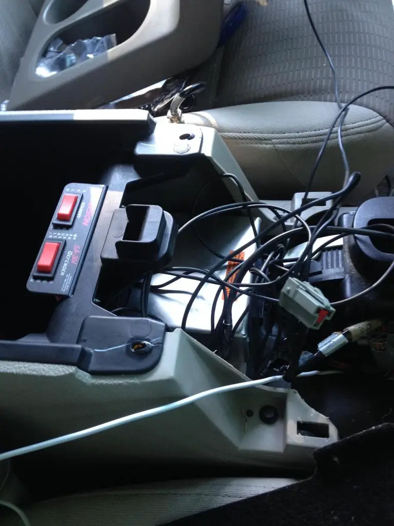

This is the Siren Switch next to my pager, You can see how small it is so you can put it anywhere

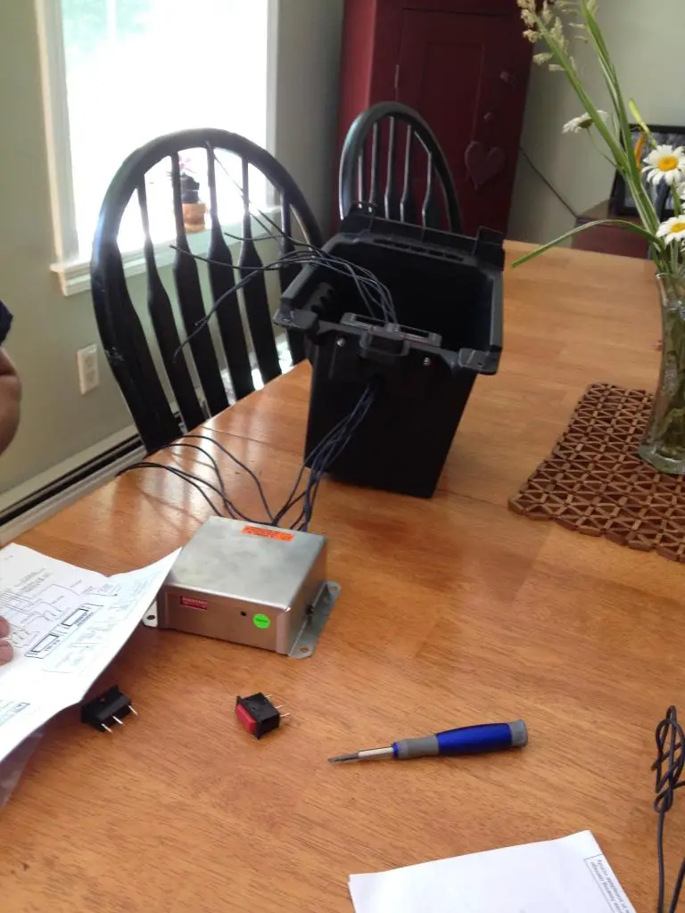

The Silver box is the Amp for the Switch you can see how small it is so you can put it any where, we took out the bucket in the center console for the arm rest because we were going for a under cover type of install
Here we have the Switch and the Amp. The is in the center console for the under cover look so everything is hidden

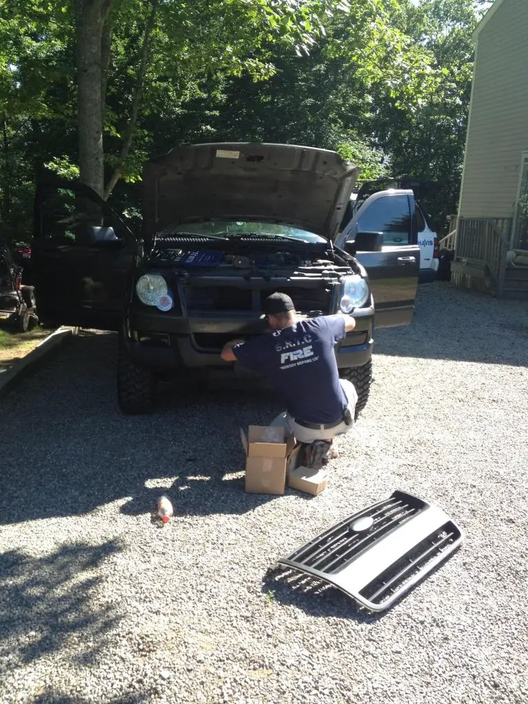

Next, we Pulled off the grille and started to feed all the wiring from inside the car through the firewall to the grille to power the siren and grille lights

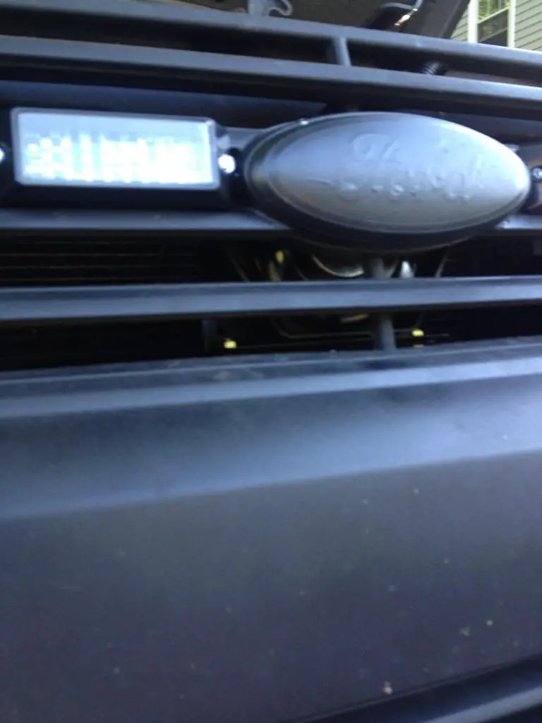

here you can see where the siren speaker is in the lower part of the Grille, but we didn't end up putting it there. we put it in the upper part of the grille and it is behind the ford emblem
Here you can see where we mounted the Grille lights. We took two pieces of metal and cut them down to the size of the light, we took screws and screwed them through the flange and then into the metal in behind the grille for a sandwich type of install
Just finished the wiring and putting everything back together
Here you can see the Siren speaker behind the Ford Emblem this speaker is very loud! and does what it needs to do

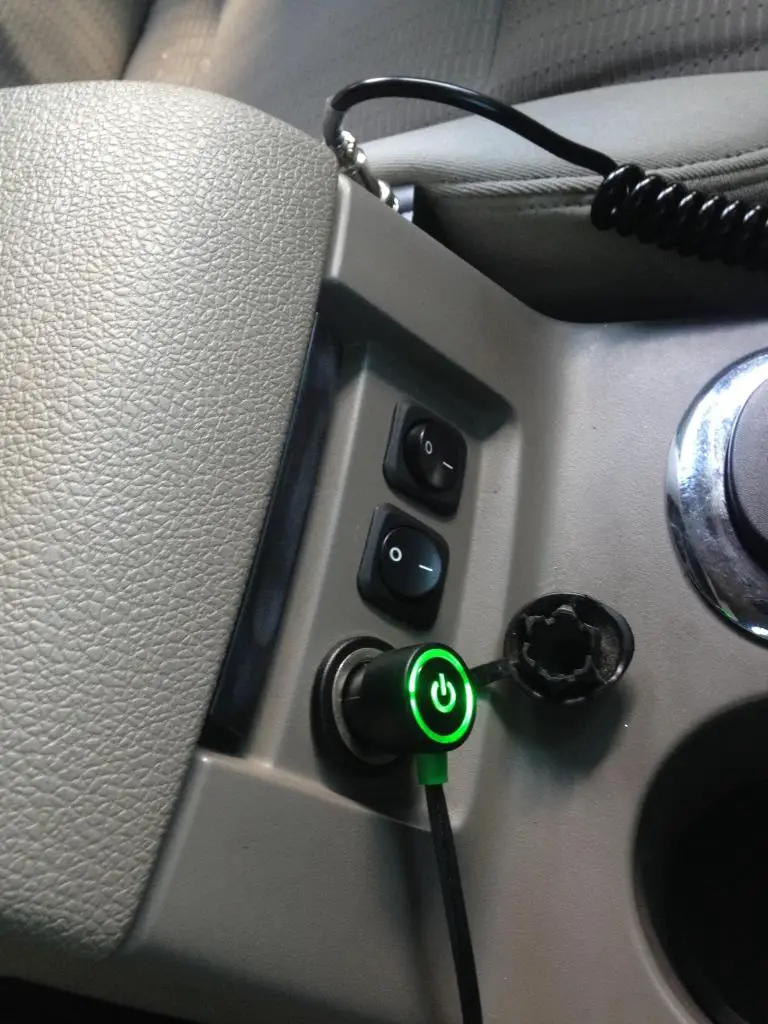

We put in two rocker switches in the console, the one on the far side is for the grille lights, you flip that and they turn on. The switch closer in the picture is for the siren switch the siren won't work unless that is flipped on, we put this in for a reason if I'm in the car with friends and the try to play with it or if i have a family member use my car for the day or something light that i think its a great thing also so it does accidentally get turned on
