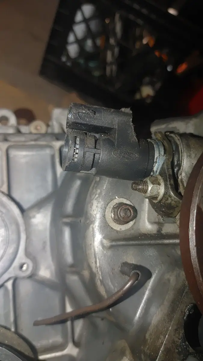

Hey quick question so using the. VEEPAK I turned on the speed sensor. I am not sure which one this is. But very telling. It said 0 mph the whole time I drove around the neighborhood.

I need to find out which speed sensor part number is the one on the Transfer Case rear housing and also if there are any relays in charge of that sensor I can check also.
A speed sensor isn't going to have a relay, just go direct to BCM or PCM. IDK the part #, do any on Rock Auto look right?
Fortunately I have the old transfer case still removed. I can try and pull the sensor out and give it a good look.
Most likely The flashing lights are due to a failed control trac transfer case I have seen this a gazziloon times over the years. Drain the fluid I bet there are bits of white nylon in the fluid at the bottom, the guide has failed your t case is bad and needs rebuilt
First up take the speed sensor out and inspect it. Change it for the one from your old t case.

Yeah I guess so. Odometer seems to work fine. But the gears just don't switch good. So I'll start out swapping the sensor. Just to be sure it's this one right?
