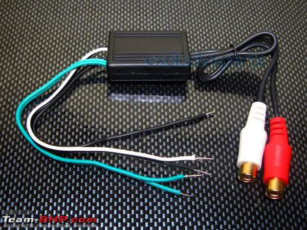

the hi-lo converter worked for me as my amp didnt have speaker level inputs

Theres a high input with a white female connector, and you can use that with the wires, or use RCAs.
