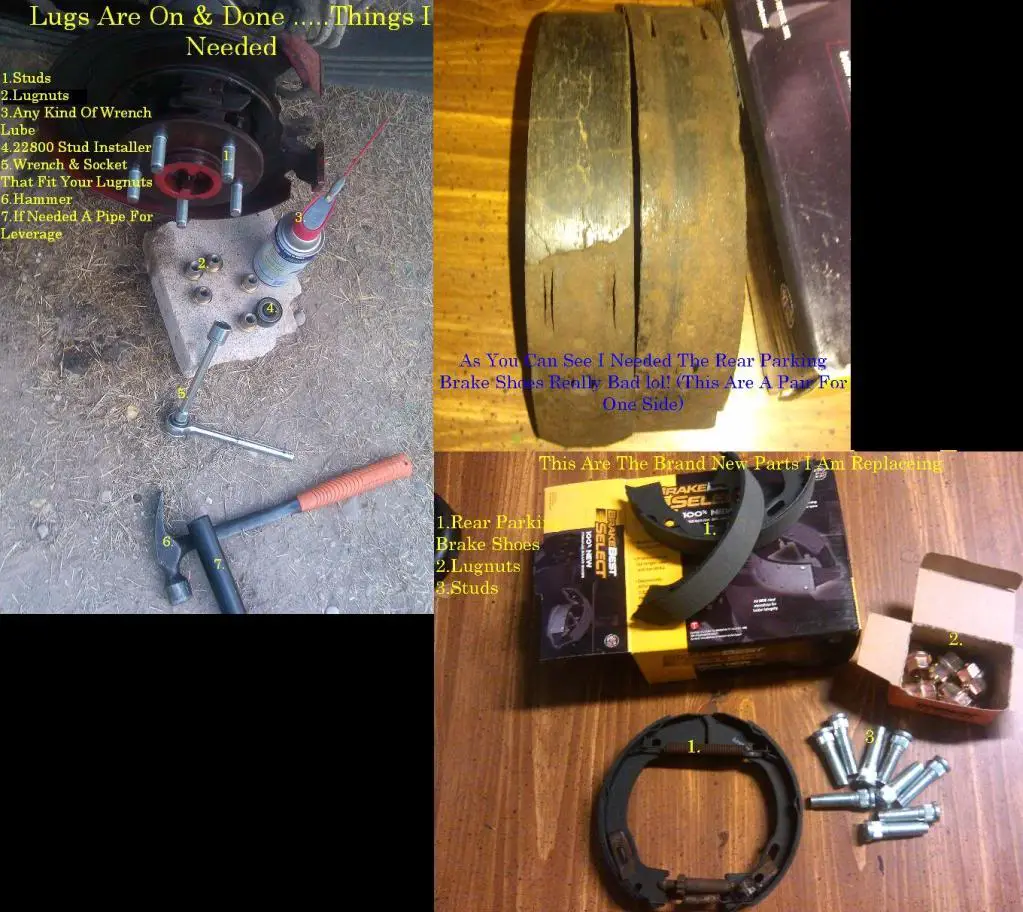

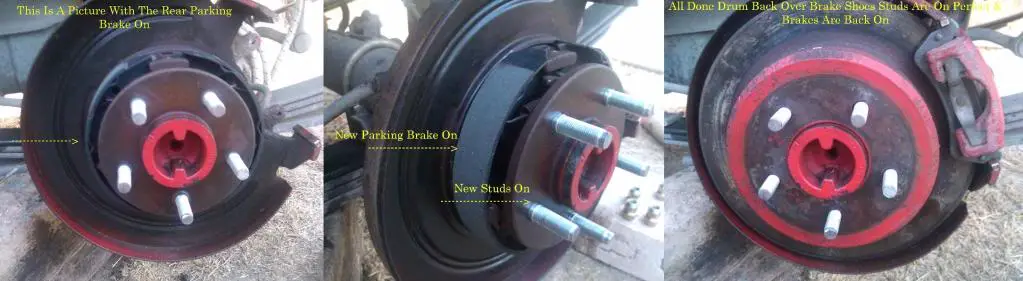

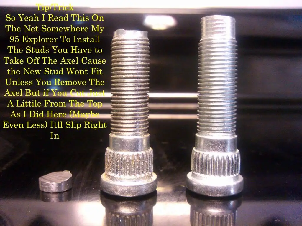

ok This Is On How To Install New Studs On A 1995 Ford Explorer XLT without taking apart the whole rear end Reason I Did This Is Cause On 95s There Is No Acsses To the Studs On The Shield you have to take the axel off so i read this on the net from some ford explorer expert guy simple just cut off the studs just a littile for clearance heres some pictures (note to remove & reinstall the parking brake there are videos on how to on youtube) this is just for easy stud installation
