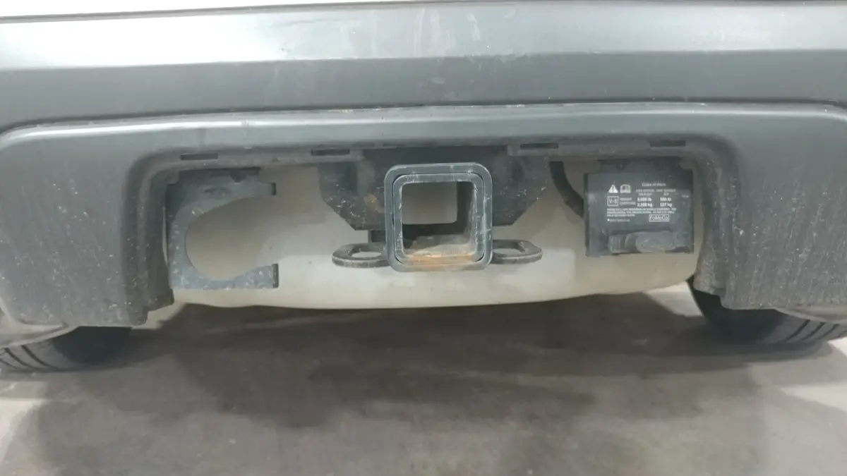

At work we have a 2015 PIU with street appearance package (shifter-less console), and it has an OEM Class III hitch. The existence of this vehicle proves what I want to do can be done. I just don't know if the bolt holes are threaded deep within the body and I can't see it? Or if the bolts thread a collar of softer metal when inserted? Or if I need to get the body tapped out before installation? Instead I'm just being told to by a Curt hitch.

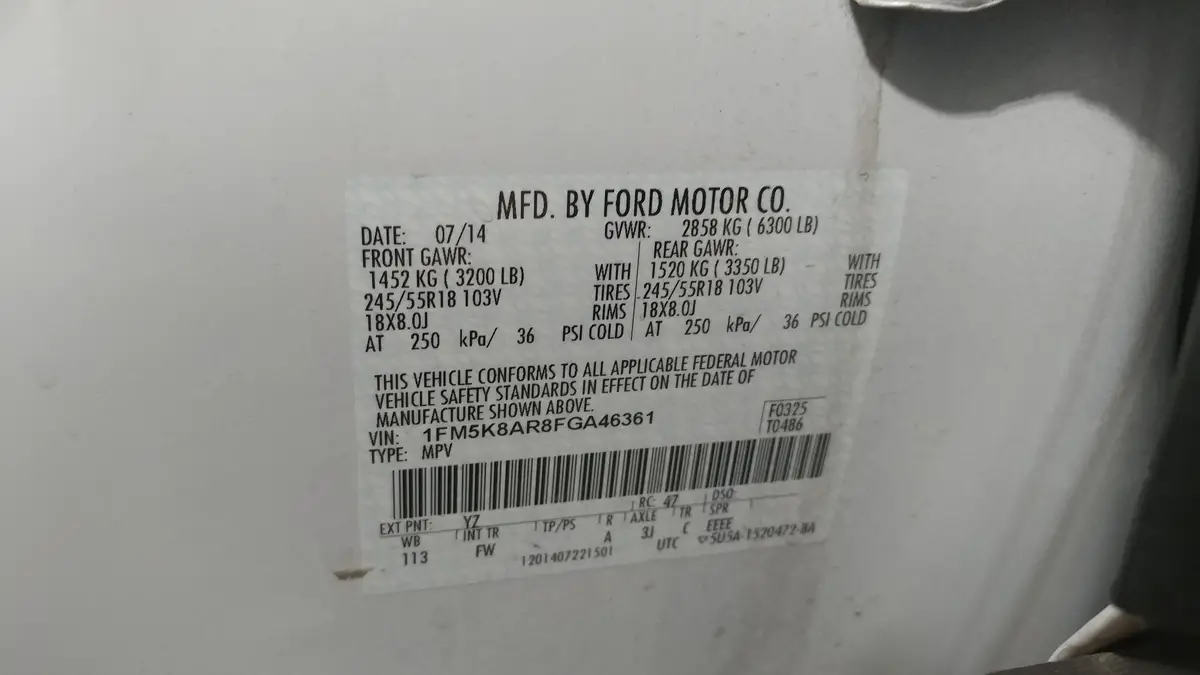

Here is the VIN sticker for the 2015 PIU with SAP at my work:

No mention of a hitch on the build sheet and it says less tow package.

Well I'm not sure then, but that's an OEM hitch on a PIU. Perhaps added at the dealer?

OEM hitch on explorer is part of bumper beam/impact bar. Aftermarket hitches usually mount off rear frame rails.

That white vehicle is owned by my employer. Not mine. It has been with us since delivery in 2014. No accidents. It's possible our mechanics added the OEM hitch, but our mechanics typically just buy the aftermarket hitches that install under the bumper for the rest of the vehicles.

It was probably the dealer who added it then.

The pictured hitch on the 15 is the official Ford Accessories Hitch Add On.

As far as I can tell, yes the bolts are self tapping. It’s why they have that odd section at the nose without threads. My civilian 2015 Explorer didn’t have threads either but I just put the bolts in the holes anyway and held the trigger down on an impact wrench. The screwed right down and when I took them back out to check the holes had become threaded.
