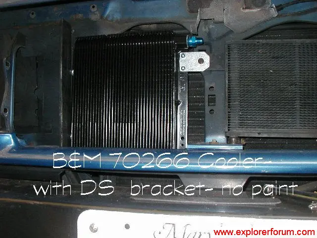

cooler pic
heres a pic of the cooler install on my 91. I mounted uit with rubber bushings and metal brackets. A cooler is a great idea.
