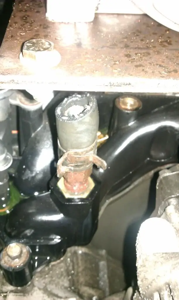

In the process of building my "super cheap budget" supercharger build I ran into a snag.. the supercharger intake box i built was in the way of the heater hose coming out of the intake... no big deal, i can get a 90 deg fitting and trim the hose..
nope.. with a turn of a wrench I hear a snap crakkle and pop to my surprise the fitting is now in my hand along with the piece from the intake and a crack in the manifold...:mad:
I have fallen victim to the ford pi intake crisis... so this is where I need your help. Do I

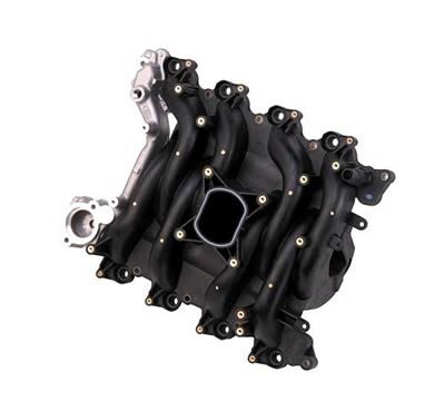

the full plastic intakes are junk, if anything get the plastic metal one, less you can afford full aluminum.
Dorman makes a replacement with all the latest updates. IT comes with gaskets and all the stuff for the install. Usually pretty cheap compared to an aftermarket intake.
You can get that Dorman one at Rockauto for $184 before the EF discount.
