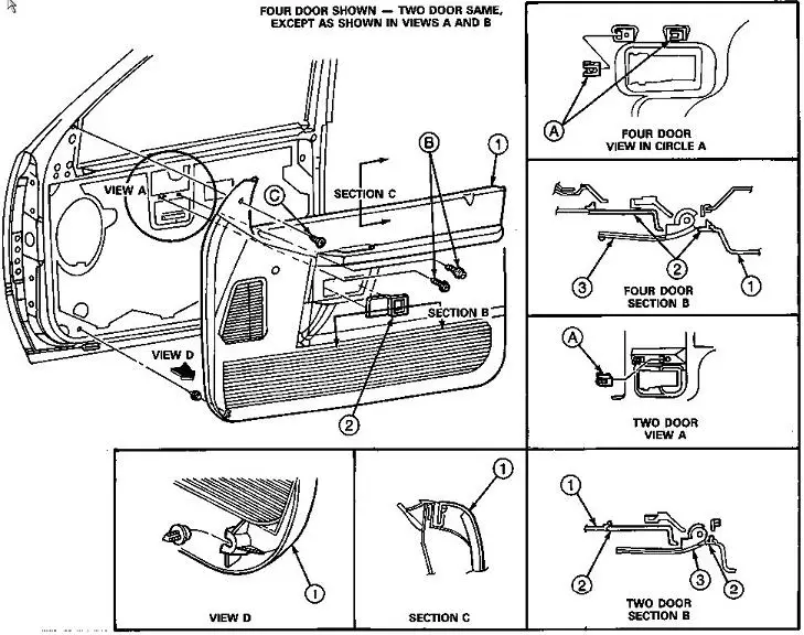

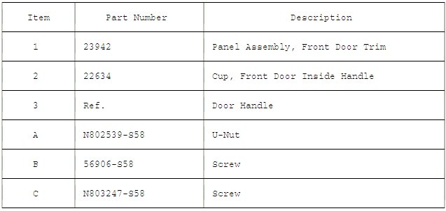

Not sure if this is helpful but I have long needed the odd panels for the manual windows like you are mentioning. Today while looking for something else in my Dealer Service Manual I found a couple things.
-Ford called the panels "Lo-Series" type
-The part number for the panel is 23942. No color is listed, believe that's in the suffix.
