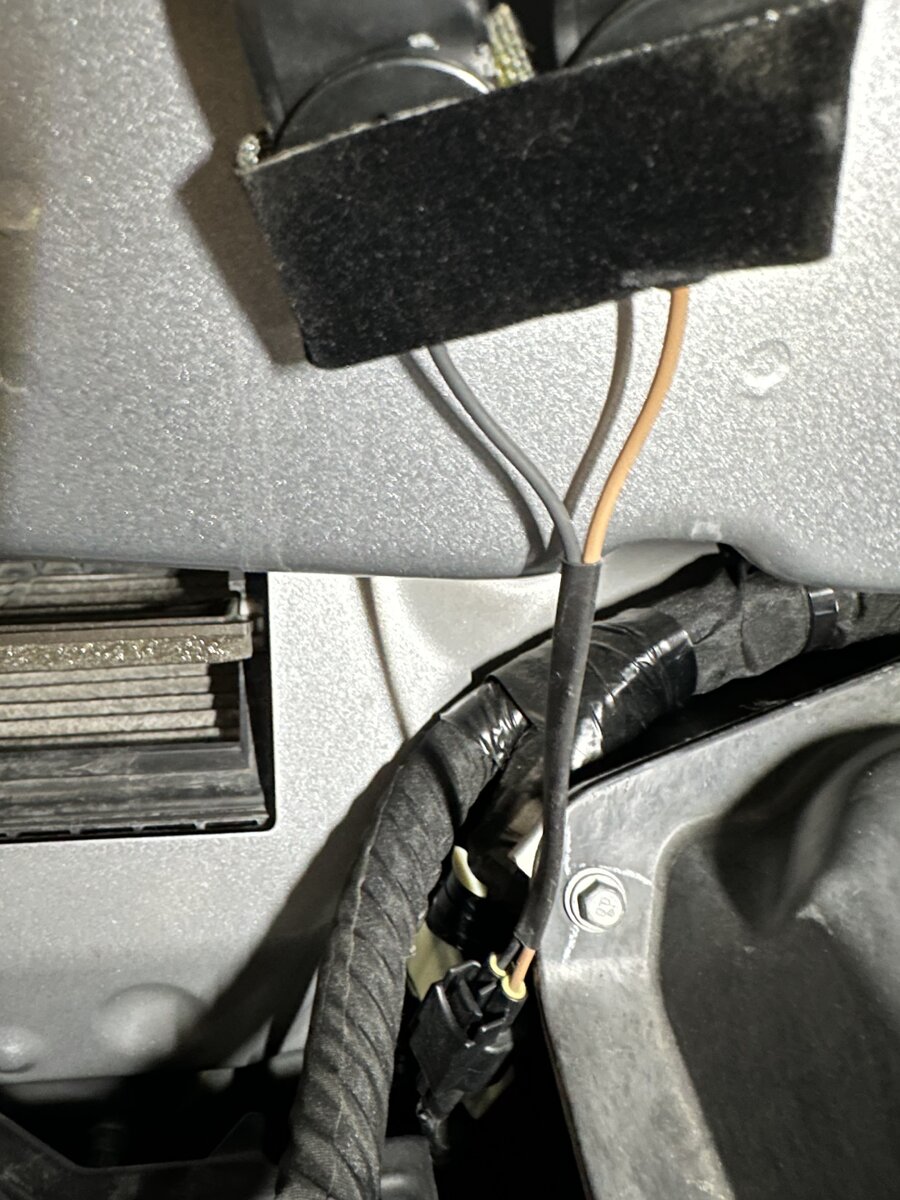

I decided to run a relay right behind the battery and trigger it from the heated mirror. I only need to pull 1 wire thru the grommet and splice it into the hot wire for the passenger mirror. By doing it this way, the heated windshield will only be active when the heated mirrors/rear defrost are active and I don't have to worry about overloading the circuit because of the relay. All I need to do now is find the hot side of the heated mirror circuit for the passenger door. Also I would like to find and purchase the other side of the connector that the windshield plugs into, that way if I ever need to replace the windshield again, I can just plug it in.
So if anyone has access to the wiring diagram for the heated mirror circuit, that would help alot. Also if anyone knows where I can buy the connector I mentioned, it would be much appreciated.
