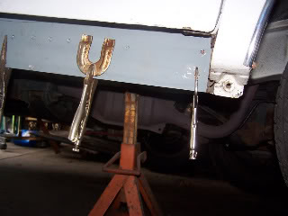

Heres a pic of how it looks so far, its not completely done but its driveable.
I cut out a part of the rear fender since it was pure rust and is going to get changed, I will detail that when I post the story

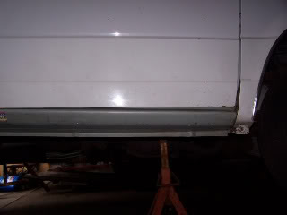

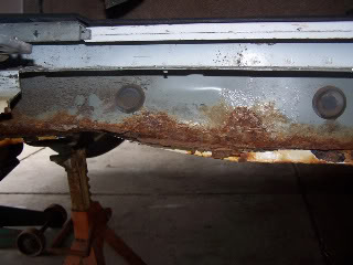

Here are some random pics in no particular order.
In this one, I wanted to show I did not take off the sliding door. I just unbolted the bottom slider. Tried to make my life as easy as possible
You can see where I cut the old rocker off
Another view of the rear part
this is the B Pillar area and you can see where I started cutting away the innner rocker
this is where I made my big mistake. This piece was not wide enough, even though it looks like it. Make it wider, you can always cut it off later, I had to weld a piece to the bottom of it after the rocker was installed and that sucked!!!
here are a few pics of the rocker just held in place to give an idea lf what it looks like
I still had to remove that rusty corner, how to fix that area ended up being the biggest challange.
this is what it looks like now, the sliding door still needs to be done yet. I am going to replace the lower panel. the patch I made by hand is the small piece in front of the rear wheel up to the lowest body line. I still need to trim a little of the lower lip. The only part of the job I am not real happy with it the lower lip. Its kind of uneven from having that inner piece too short, I did not realise at first and clamped it in place, started welding then realised my mistake. By the it was too late, I could have drilled the plug welds out and started over but i can live with it as is. Its not real obivous unless you look for it.
