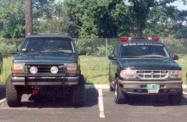

IMO NO.. they are going to be way to wide... In the pic below is my '93 4.75" lift with 33x12.5x15 BFG ATs on 15x10 AR rims (3.75BS). As you can see in the pic the tires stick out quite a bit compared to a stock X; Your 14.5's would add about 2" to each side :eek:
Pete used to run a 6in SkyJacker Suspension lift in front, 4in SkyJacker spring and custom shackles in the rear with 33x14.5-15 TSL Boggers on American Eagle 589 alloys on his Sport. With the right Back Spacing on your rim I would say yes.

10" rim definatly, I wouldn't go smaller. For BS I would say 3.75" - 4". I think Pete's were 4" BSing.
On my B2 with a 6" lift and 33x12.5s I have a 8" rim with 4" BS. At full lock I have about 1" of space from my stock radius arms.
You are going to be close, you may have to put up with some rubbing on the radius arms at full lock.
