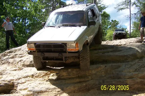

Here's mine before I sold it to Jman.

1) 33s are not "tippy." A truck that is too tall can be. If you modify the suspension and add tires, know that you've modified your vehicle handling and don't expect it to drive like a Porche. I ran 33s on mine and I think it handled better than stock.
2) Springing over the rear axle is a great way to get 5.5" of lift. It is fairly simple if you can grind and weld, and even if you can't it is a reasonable job to take on. Just pick up a set of weld on spring perches, figure out where they have to be on the top of the axle, and weld them on. You'll also have to extend the brake line if you go that route, and the driveshaft may or may not work out. Check it. If it is too close to the end of the spines, it could come apart if you flex the truck out.
Going the 5.5" lift route means a committment to spend some real money in the front end, however, hence the suggestion to lift it about 1-2" with cheap means and use a body lift for the additional 3" (doesn't effect suspension and is cheapest way to go). Up front, you'll need a 6" lift, which means steering issues that are pricey and difficult at best.
Mine in the pics above is set up like I suggested in my post -- it worked VERY well.

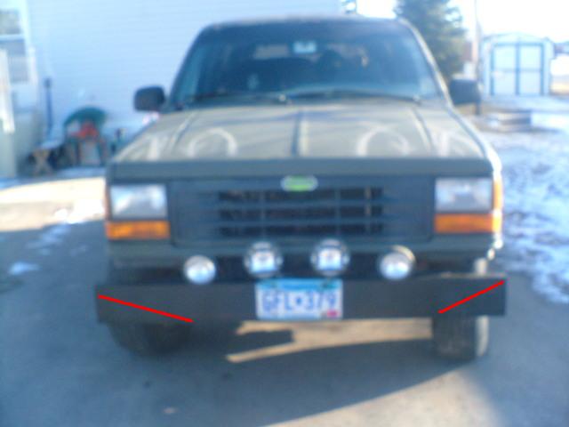

I broke down and started building up. My friend had a couple sets of 31's and I bought a set for $20 from him. I also built a new front bumper for it since the stock one was bent up when I rear-ended someone a few months back. The guy I bought the tires from has an F-350 he's parting out so I'll be buying the springs from that to raise the front and do the spring-over-axle on the back. I have yet to get it all put on the truck, but when I do I'll get some pics up!
Got the bumper and lights on it last night. Will be doing tires tomorrow. I'll probably be making a new grill for it, too. I "broke" the old one:D
Pics are kind of blurry, but when you're using a camera that's been indoors for 6 months in 3 degrees, the lense tends to fog up.
Good first attempt...
Now, go back and clip the corners off so you have some clearance, or you'll have a big old plow up front that will get hung up on everything.
When I did mine, I raised it up higher, right under the grill for more clearance.
