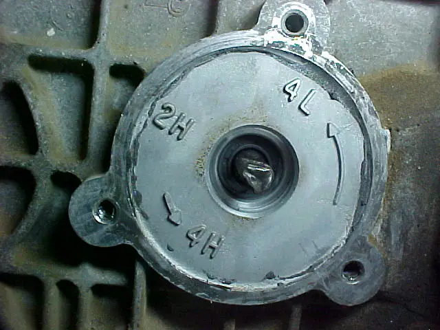

Just to clarify some things.. The T-case selector shaft (top pic) is the only mechanical link needed to engage 2H-4H-4L. If you remove the shift motor and rotate the shaft to 4L the T-Case is then in 4L (No matter what the little dash & button lights indicate). The dash button(s) are used with the 4x4 shift computer to detect the current position of the T-case selector shaft and employ logic to shift or not shift. This is accomplished by the metal contacts on the selector cover making contact with the metal pattern on the selector shaft gear.
That being said if you rotate the selector shaft into 4L and drive off road you will definitely notice the difference compared to 4H.. In 4L you will not be able to go above 25-30mph as your rpms will be @4K or so..

i actully got tired of buying and rebuilding shifter motors on my b2 so i just ran it like DeRocha's first pick.I just kept a pair of plier's and a duster in the door pocket like everyone else:rolleyes:.make sure that you are in neutral when you turn selecter shaft into 4 lo.

And if that little cover plate with the contacts is not aligned properly, the shift computer can get 'lost' and will refuse to shift because it doesn't know what gear it is in.
