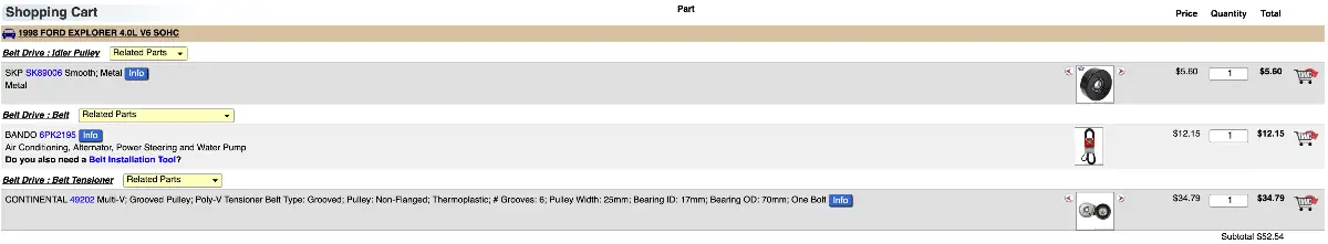

Thinking of getting a new idler, tensioner and belt from RA (attached image) unless anyone has a better idea of what it might be...

I've ordered the Dayco kit from RA that has the idler, belt and tensioner.
I was thinking of doing it super cheap and just replacing the pulley wheel on the tensioner for about $10, but I'm sure all these parts are original and I'd like to just do it once and forget about it.
