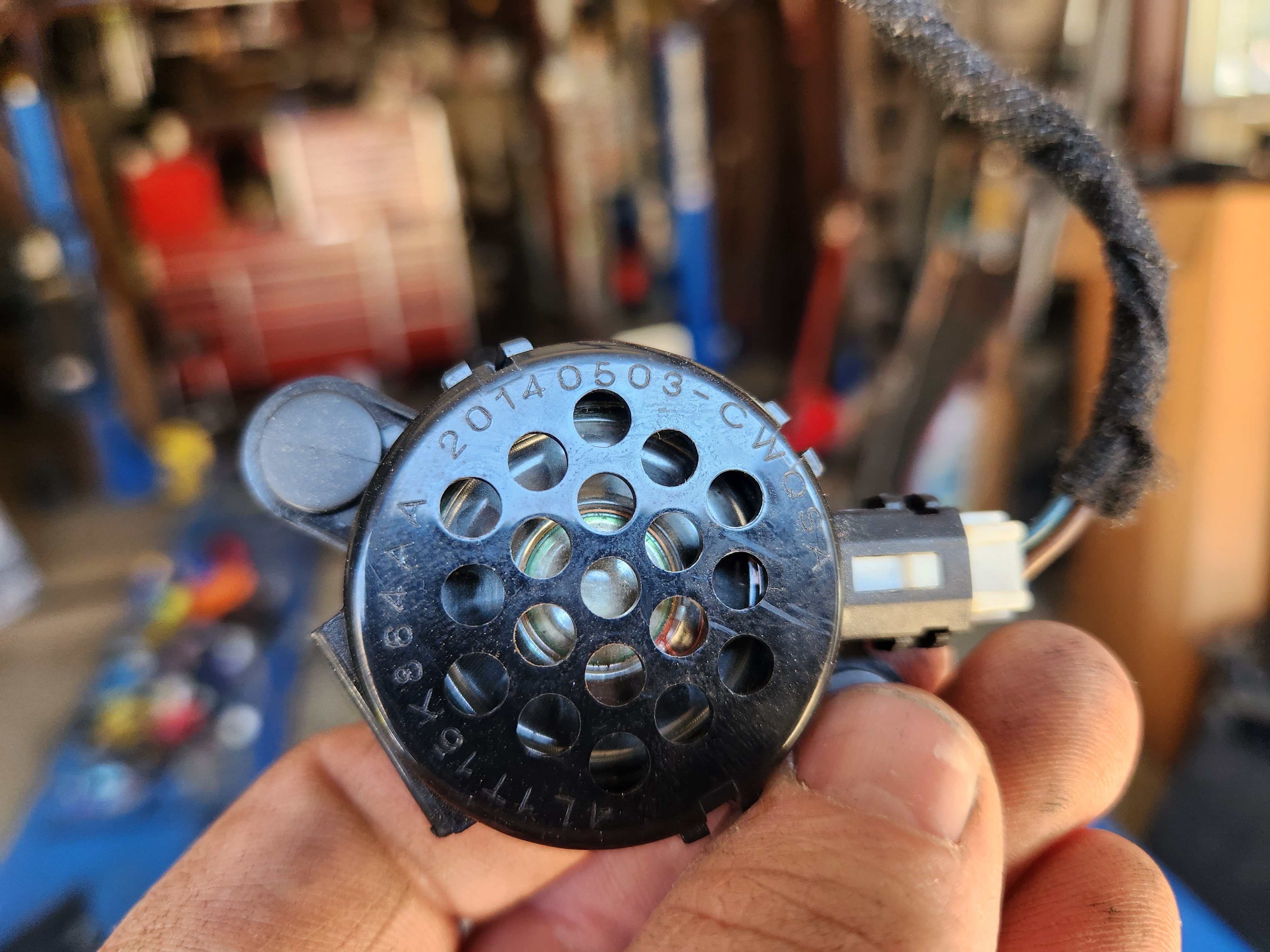

alerts are coming out of the IPC not through the Audio system...
I don't think the IPC has the capability to produce sound internally. But there are some tiny buzzers inside the dash for park assist, etc.
