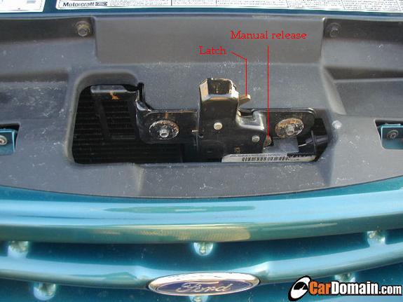

Found this post and picture, might help.
Welcome to the site, wpsatisfide . For you hood issue, mine just started to do the same thing. If you use a s thin screw driver, you can open it. Look through your grill at the latch for the hood and you'll see a small horizontal slit. Put the screw driver in the left side of that and move the arm towards the passenger side of the vehicle (so the end of the screwdriver in the hood latch moves towards the drivers side). That should release it, fiddle around in there and it will pop open.
