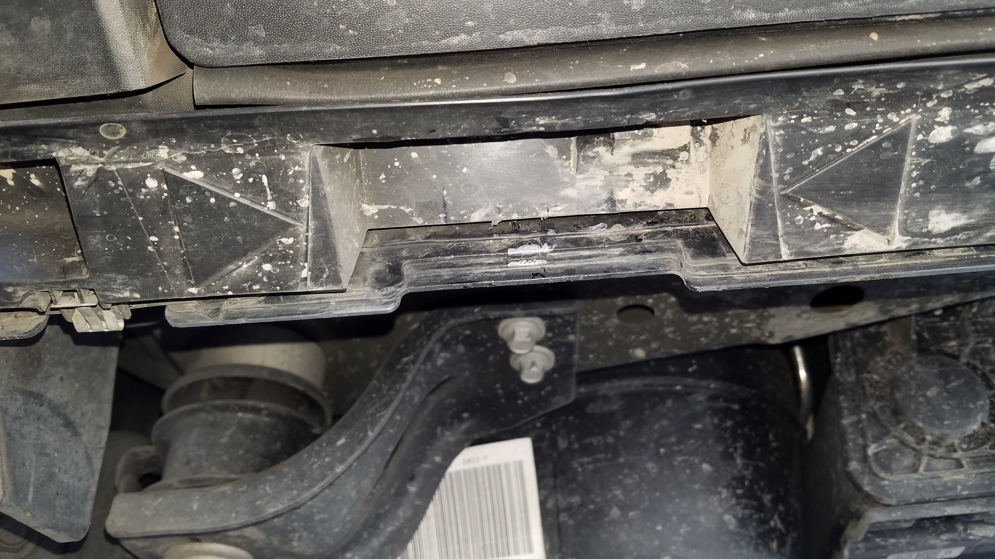

Front subframe, just behind the air-dam. Worked great for me. Right in the middle up front. I put my jack stands at either end and sat the Ex down. Lifted the back by the dif. Only problem was removing the ducting on the passenger side with the jack stand in place. I like to rotate my tires at oil change intervals, hence dropping the duct work. I'm surprised, at 7500 miles the tires are wearing very evenly...
Thanks! I forgot that the front subframe was there.... I'll have to try that.
What about placing the jack stands farther back out of the way of the duct.... Ie where the subframe bolts to the body? Haven't tried it yet, but might be an option...

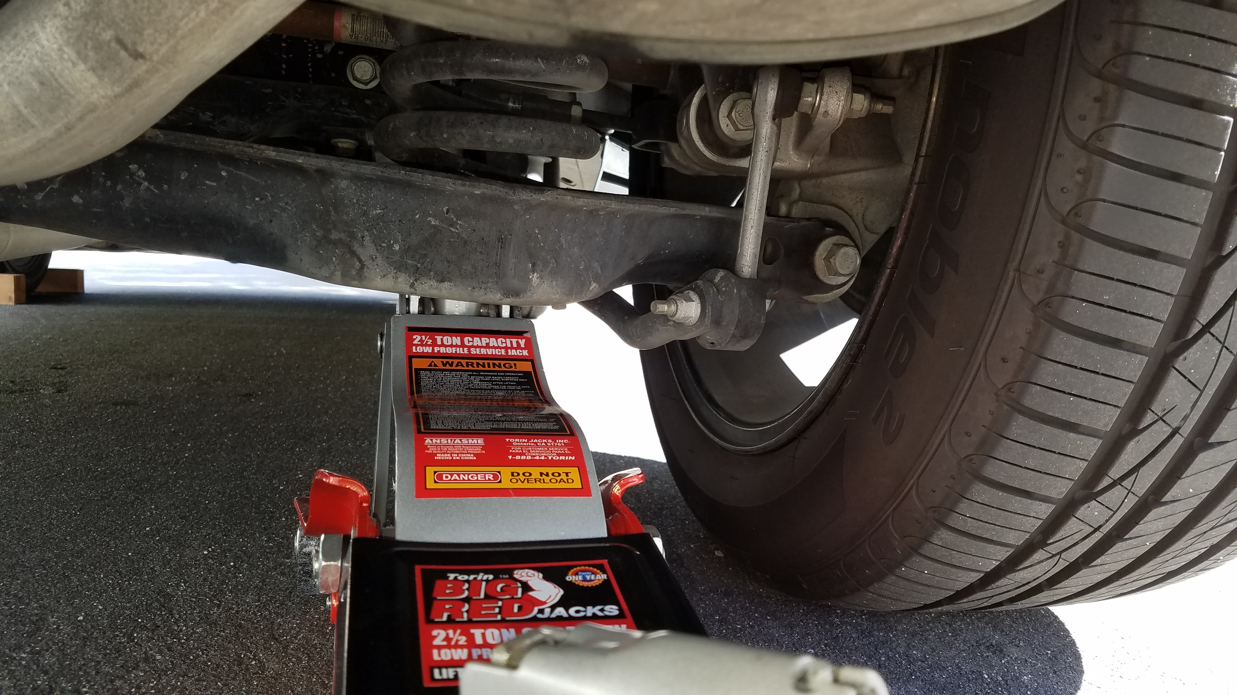

I jack up the front where the springs meet the control arm thingy. Then I place the jack stands under the front jack points and lower. Then I drag my floor jack to the rear use the same piece of really tough looking metal that the receiver hitch is installed on and again slide the jack stands underneath the rear jack points and lower.

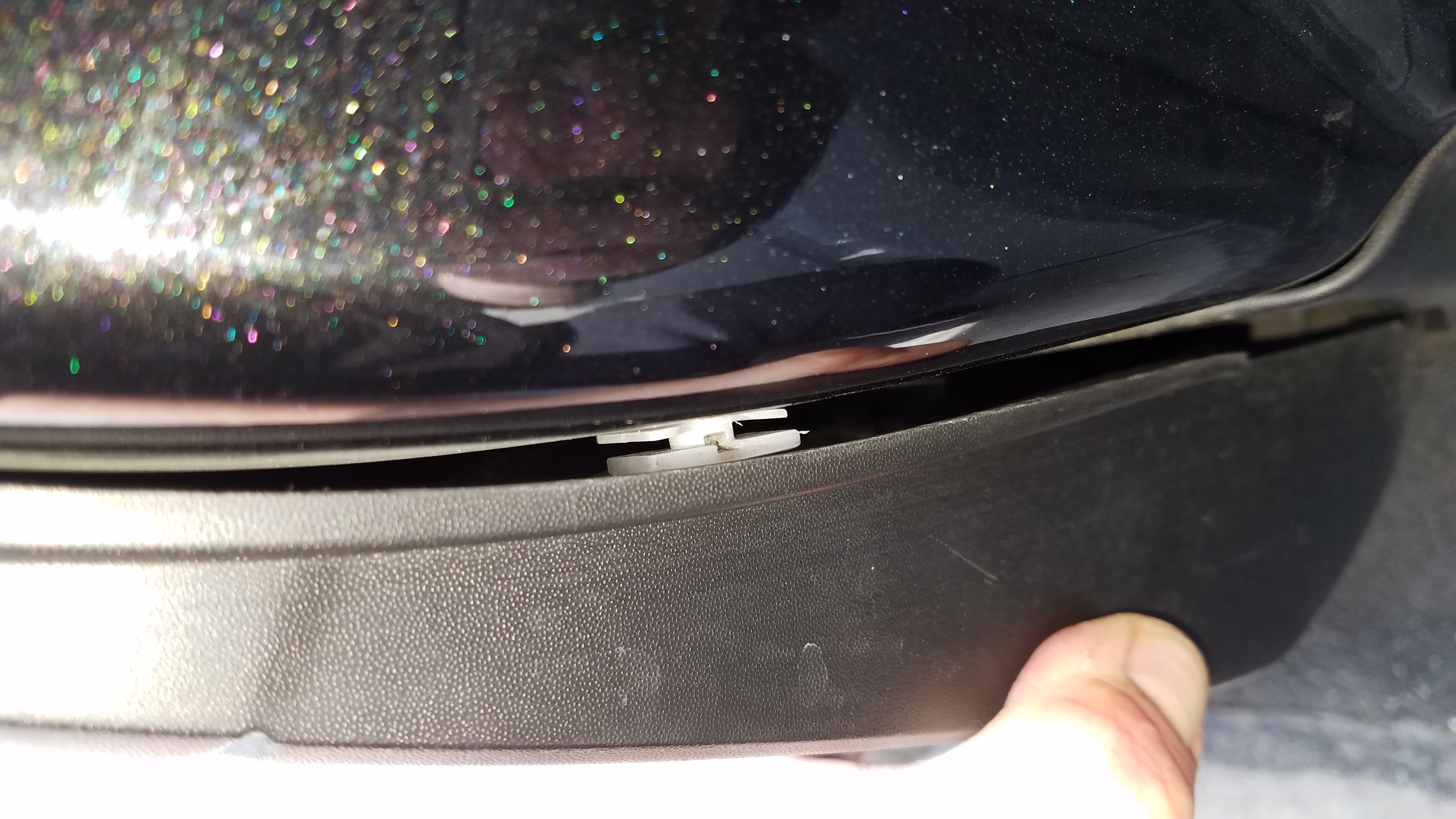

So I tried jackin the ride up to finally paint the calipers. Used the point the manual said that is marked with 2 arrows. Was almost there when all the sudden the car dropped. Removed the jack. Opened the rear door & all the side molding had been pulled away. Got all back in accept 2 within the wheel well. WTF happened ??
As far as I can tell, all is good. Almost pissed myself when it dropped. Gonna wait till I have a floor jack this time. My low pro one can't get the tires off the ground

When I did my calipers I jacked up under control arms with a floor jack and then placed my jack stands under the 'suggested jack points.' Same process in the rear. Takes a bit longer this way (one side at a time), but ultimately it proved to at least 'feel' safer. I tried using the suggested jack points and then sliding the jack stand under there, too, but that seemed pretty sketchy and I gave up on that pretty quick.
Agree with @blwnsmoke, though. I haven't even looked at the jack provided. Those things are usually borderline junk and make the process take that much longer.
The diameter my jack's saddle is wider than the lift point and resorted to using a puck in between, which fits right in between.

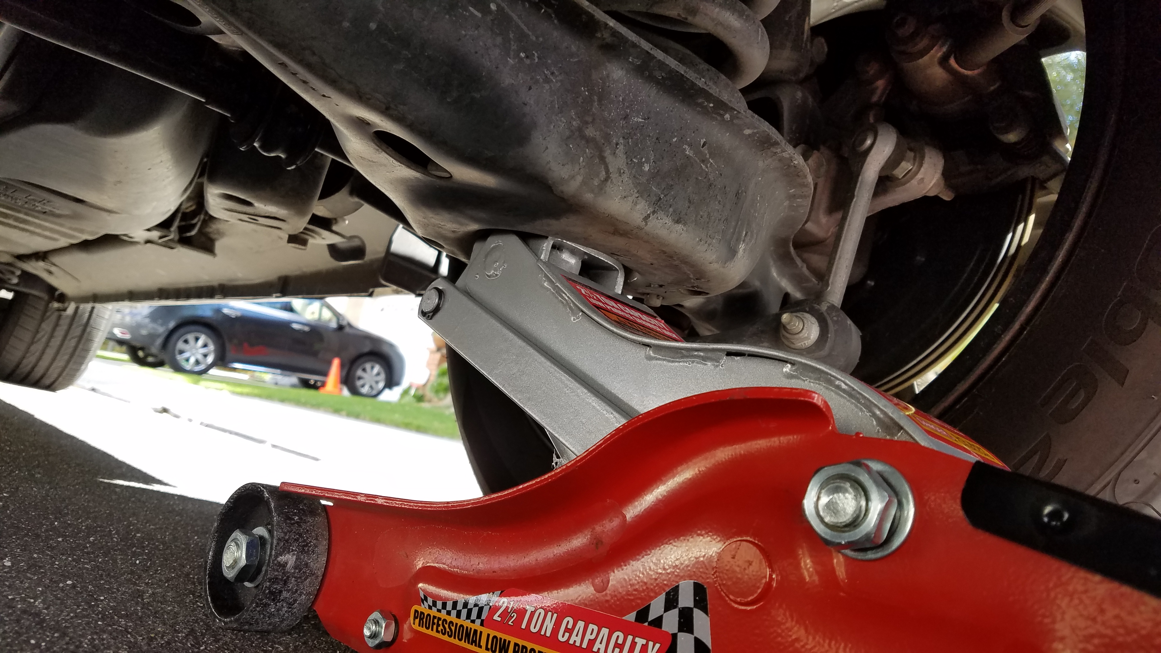

Hey guys,
Just wanna make sure I can use this point to jack the car up. Thanks
Hey guys,
That's fine. That's a really strong piece to deal with the Spring. Mechanic told me to use that point every time.
I am at work ATM so I can't post a pic but what about the front area ?? Don't really see an obvious spot to lift from.
I use that point also when doing tire swaps.
It's going to get scrached up, but putting a piece of a 2x4 there to protect the finish didn't give me the warm and fuzy.

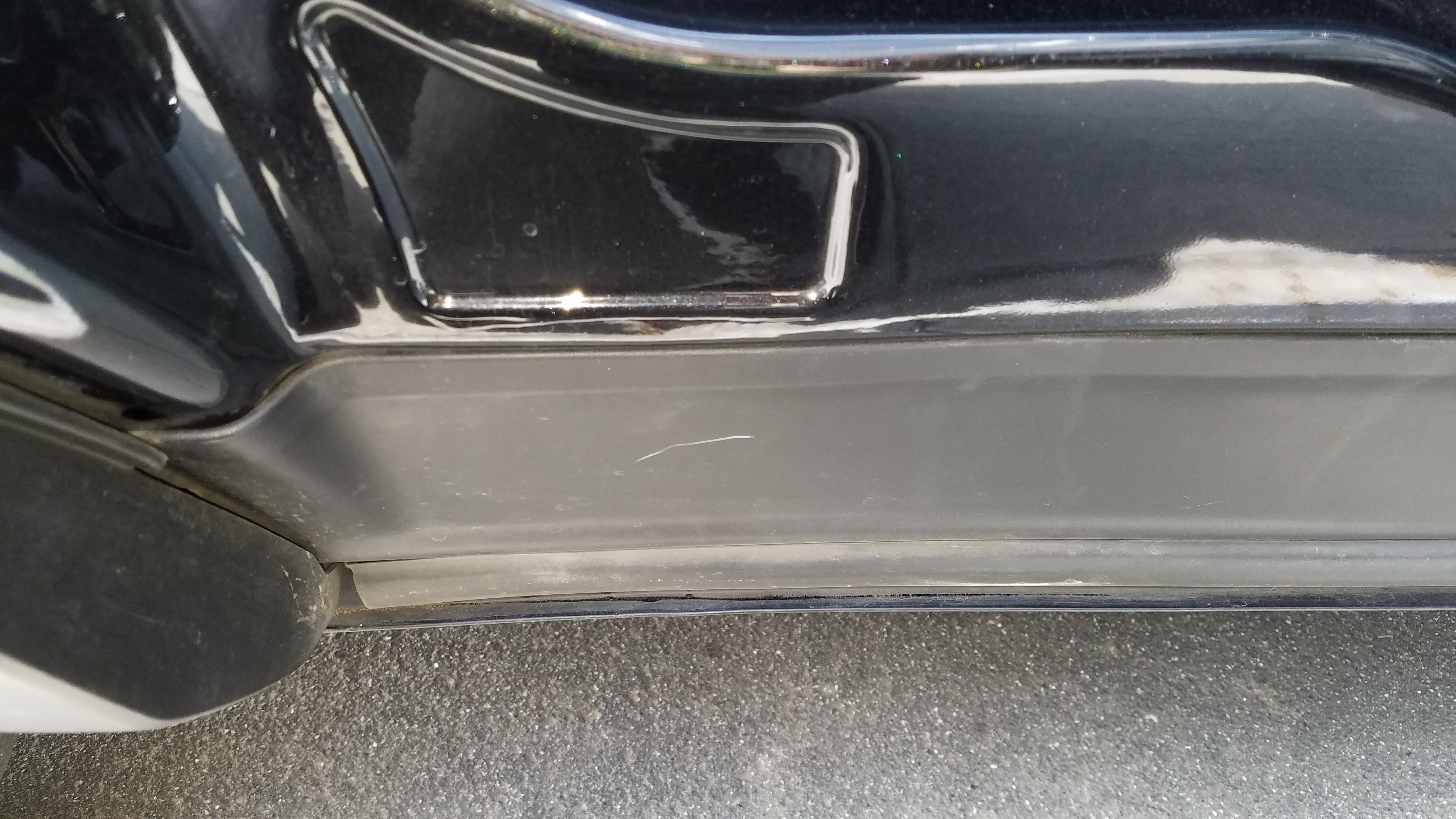

I have been having trouble finding the best way to jack all four wheels off of the ground on 18 Explorer. Any suggestions would be great.
Also, once the vehicle is lifted, do I place jack stands directly between the arrows inside of the cut out? Or do I turn jack stand sideways so the pinch weld sits on the middle of the stand?
