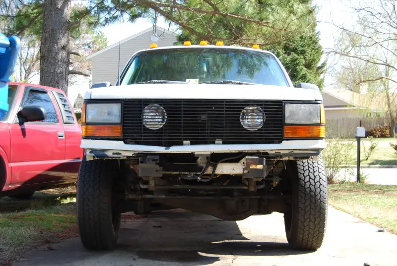

2 - shoved my hellas behind the grille for a cleaner look. used the brackets from the e-fan to hold them on

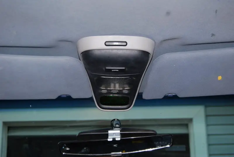

3 - 2nd gen overhead console. no wiring yet and its a tad to much to the left. i can fix that later.
