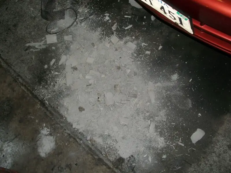

oh yea, i figured while i cat the cat unbolted to check everything and clean the surface for the gasket id do this:
its only the 2nd section of the cat, not the whole thing. i didnt want it to be too loud. has a different rumble at idle and in 2nd-3rd then the engine drowns it out.(when flooring it)
