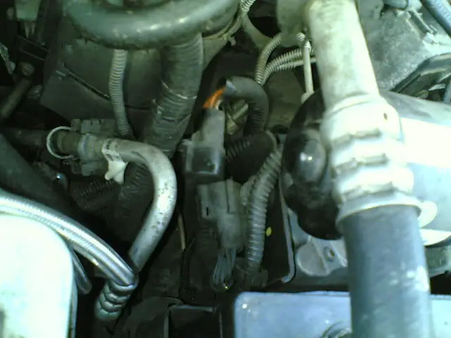

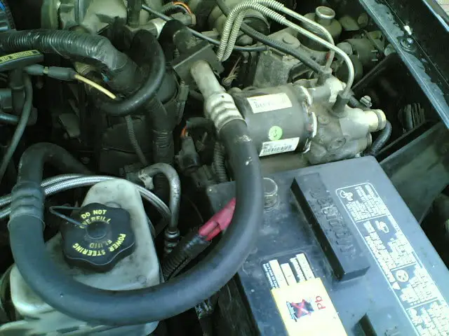

If disconnecting the ABS does the same thing on mine as yours Blueka then I guess we are on the right track. One question - how do you disconnect the ABS?

there's a plug on the the near side under the bonnet - just undo it... i'll take some photos of the plug tomorrow and get it up on the net for you
Si

As promised, some pictures of the unplugged ABS plug
Hope this helps
Si

I'm off to disconnect - let you know what happens
JJ
Yep - it worked! No more problem (except if I have to brake hard at speed!!)
