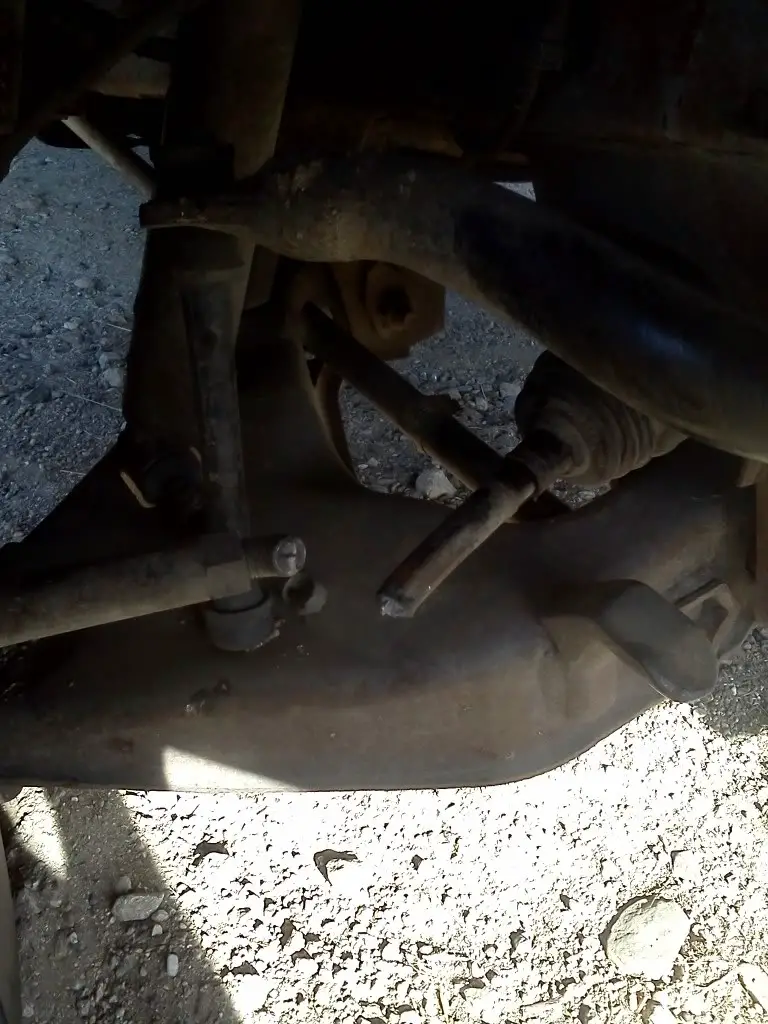

Is this fixable or do I have to replace the entire steering rack?
If it's anything like a Mustang steering rack (shouldn't be any different) you can just replace the Inner Tie Rod. It is not real difficult. They just bolt on.
