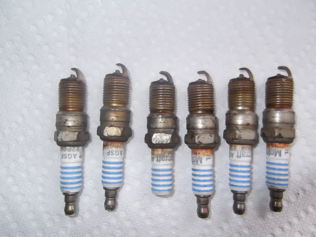

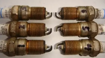

Changed out plugs in my 02 Explorer yesterday. I bought it used, 6 months ago and never seemed to have any issues, but just wanted to change them for my piece of mind. I was shocked when I pulled the first one out, the gap was at least twice or more the recommended .054. Got the pass side done, when to the driver side, got to front one. It was another OMG. The top electrode was totally broke off and had rust on it. So basically she was running on 5 cylinders.
