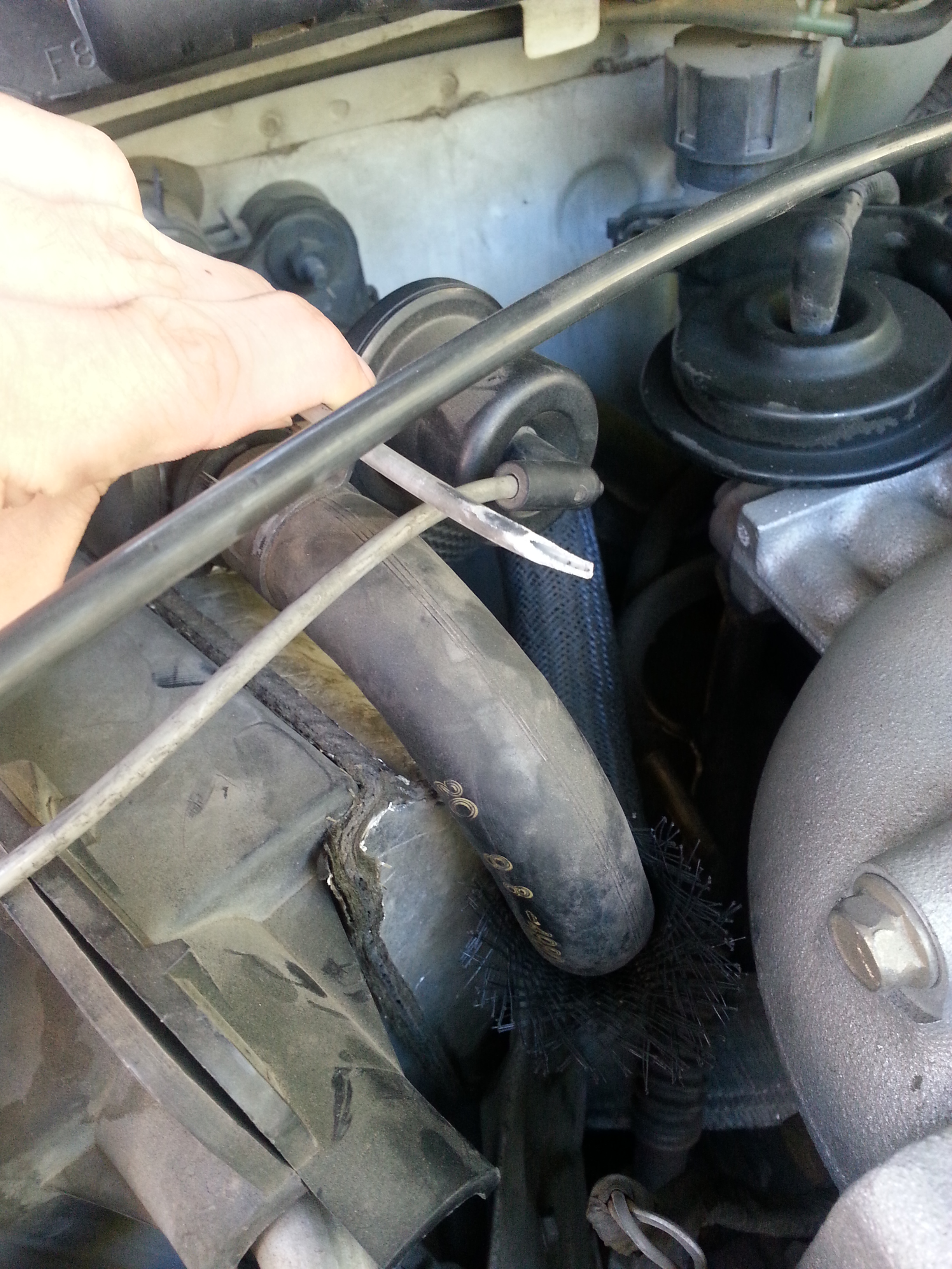

Anyone know what this is? Where it goes to?
https://hostr.co/file/arm9tNxrGfzg/20131107_144918.jpg
looks like the heater control valve. the vacuum line activates it. the line goes down to a vacuum source, which should be down by the vacuum ball/reservoir. the ball is located in front of the passenger side front wheel on the top side of the plastic inner fender. that line may also go through the firewall to the HVAC controls - i'm not sure which.
Ok will have a look.
