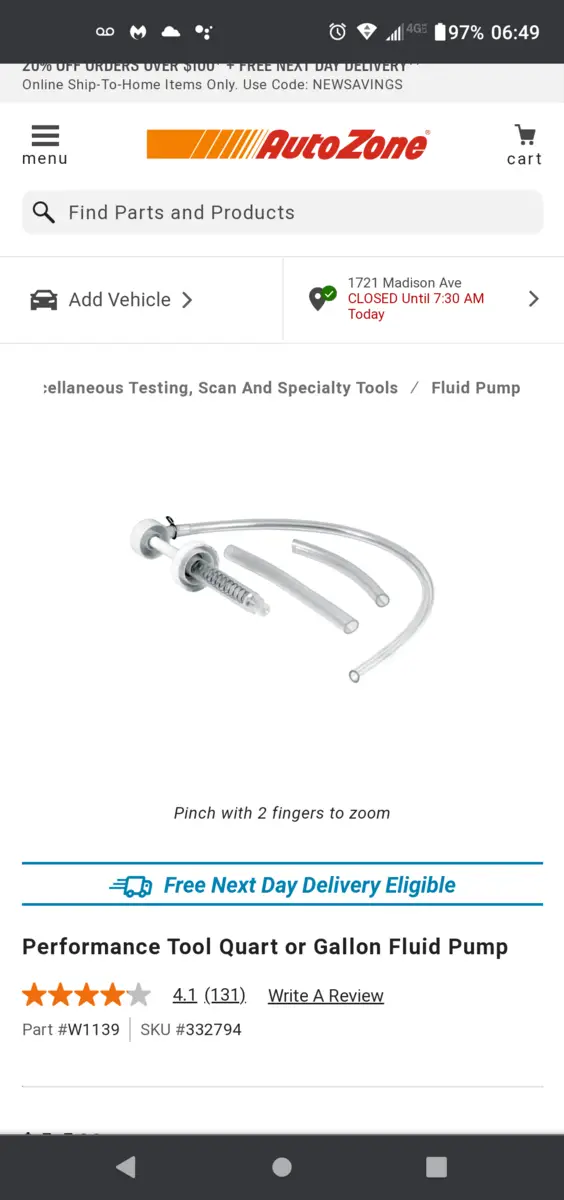

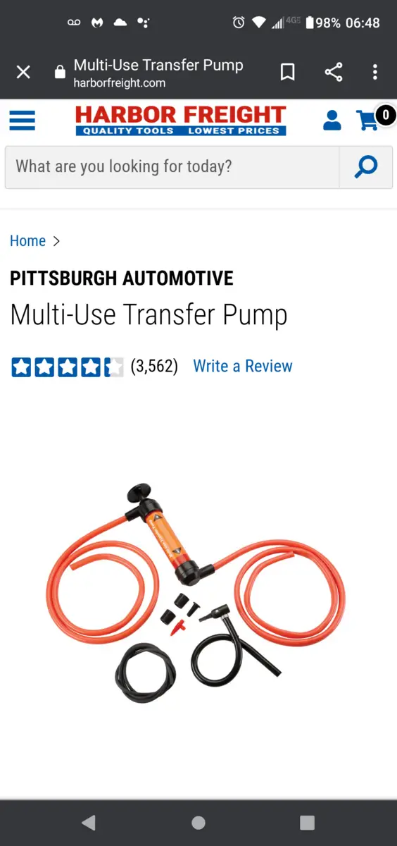

I use both of these. The red one is great for pulling the oil out, and the white one screws onto the top of a quart or gallon jug so you can pull straight from it to fill an axle.
They make fancier, more expensive options, but these will work for what you're trying to do.
That top one for pumping fluid through the two hoses are good, but try not to pump gasoline with them. They have poor internal seals, after pumping gas they won't work well the nest time. After a couple of times(with gasoline) they won't pump at all. They are a great choice for pumping gas though, just plan for them to be one time use only. I've bought three of them so far.

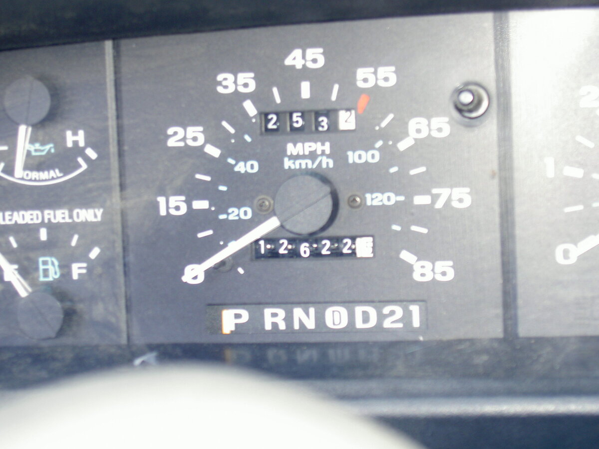

I parted out my 93 Limited with 112,622 miles on it, to rebuild my 99. I still have that cluster, the engine and transmission.
Yeah, I tried that as well. The pump didn't like it! I'm on my third one as well. For a cheap transfer pump, it works pretty well. The bottle pump is great. When you're under a vehicle, you only need to hold the output hose. The bottle holds itself to the ground when you push down on the plunger. Unless you push on it in a non linear fashion... and it goes sideways.

You can unscrew the body of those cheap fluid pumps, and find an o-ring on a plunger. ACE hardware here had the o-ring. 50 cent o-ring, and reattaching the intake and output hoses, and you have a ”like new” cheap pump.

The one I had was heat welded together. The gas softened the rubbery plastic ends and completely ruined it. Even oil over time will ruin them. The second one sat in my service truck with a bit of trans fluid in it. After about a year, it fell apart too. It was about $4 at AutoZone. It's definitely not an option for those who will use it for the long term. I know which ones you're talking about they are much better quality.
