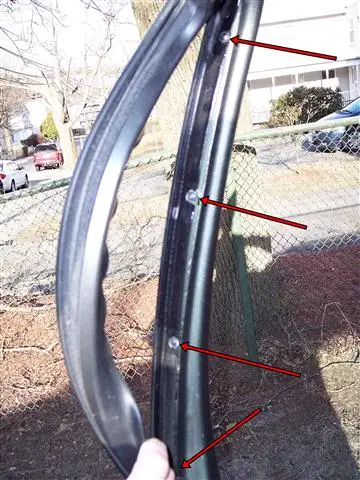

Getting to the keypad is relatively easy. These pics are for the passenger door but the driver door is the same.
Make sure the window is in the fully down position. Start at the bottom, indicated by the yellow arrow and pull the weatherstripping in the direction of the red arrows. Work your way to the top of the door. It comes out & goes in pretty easy:
There are four screws holding the pillar in, indicated by the red arrows. You can't see the bottom one in the picture, but it's there! Be very careful taking the screws out, you don't want to drop them in the door. Maybe use a magnetic screwdriver:
Once you get the screws out and start to remove the pillar trim, you will see how to remove the keypad.
