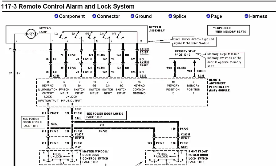

Keypad Wire Swap
Ok, here ya go, this looks easy enough to me.
So open up the door panel and swap the Read and Yellow wires, now 9-0 is 7-8 and 7-8 is 9-0.

I should also say, I pulled this from the 2000 service manual. But it should be easy enough to figure out for any other year if the color code doesnt match.

Nice work Bob! I'm going to be working on my '02 this afternoon and will try to check out the back of the keypad to get the wiring color codes. :salute:

I would bet its the same color code.

Gained access to the back of the keypad but there is a connector and no way to tell what wire goes to what button. :salute:
Dont screw with the keypad!
Its not about the key-pad, dont tamper with that. Just look at the wires leading from it, pull back the jacket and check the wire colors. If they dont match what I posted from the 2K service manual, then Ill explain in detail how to trace it out from the keypad.
