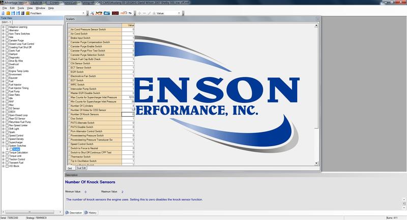

There are a ton of Ford cars which don't have knock sensors. 1996-04 Mustang GT, 03-04 Cobras, 07-09 Shelby 500's. Roush turns them off on ALL the new 5.0L supercharged cars. Betcha didn't know that one. They are present and accounted for but the switch is off in the tune. The short answer is unplug them and turn them off in the tune.
Here is a screen shot of a Shelby 500 that i tuned in the system switches section. Now this is only a switch not the values that tell the computer what to do. Think of it as the first layer then you get to the "meat" of the deal.-j

James thanks for some solid information! Id love to have you do the tune, my question lies in how accurate of a tune can you provide from a far? I assume you use data-logging and a few back and forth emails? After the transmission mods i had been planning on a new tune, but as you are aware there were a few mechanical issues that needed to get ironed out first.

I ended up not going home. So I am awaiting a response, but it's irrelevant because James told you what you need to know. You should be able to data log and get the info you need to James and he can whip you up a good tune. There are a few people that have done remote tuning sessions with him and have had great luck. I hope to be doing a session late this fall...:D
