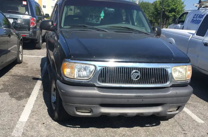

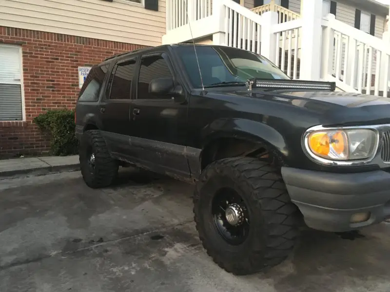

Ok cool thanks here’s a before and after pic of my baby.
