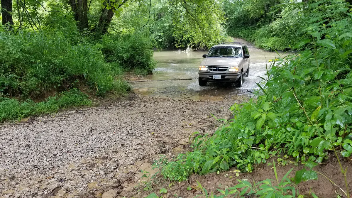

Poser shot beside Horse Lick Creek in Jackson County, KY (Daniel Boon National Forest in Southeast KY). The red truck with the bike is also ours.

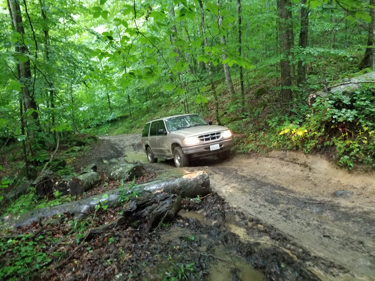

Same location. Part of the Sheltowee Trace trail which is open to motor vehicles.

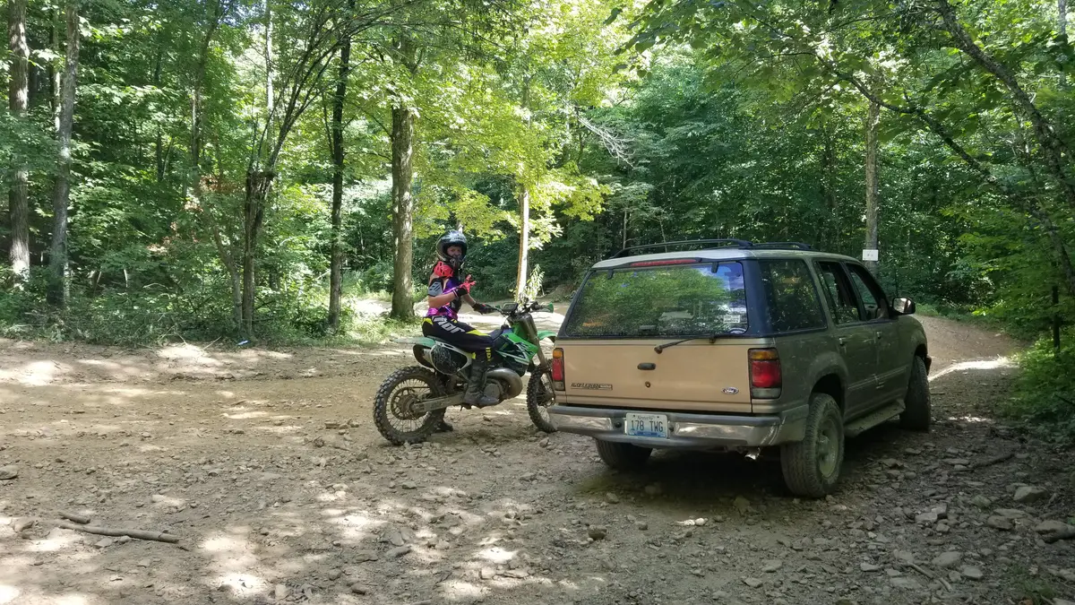

Parking lot of Rush Offroad (blue truck is a company vehicle we were using).
My wife Dinah on the bike at Rush... We took turns all day between the KX250 and the Explorer (it was in the high 90s both days so after a couple hours of riding the AC was a welcome relief)

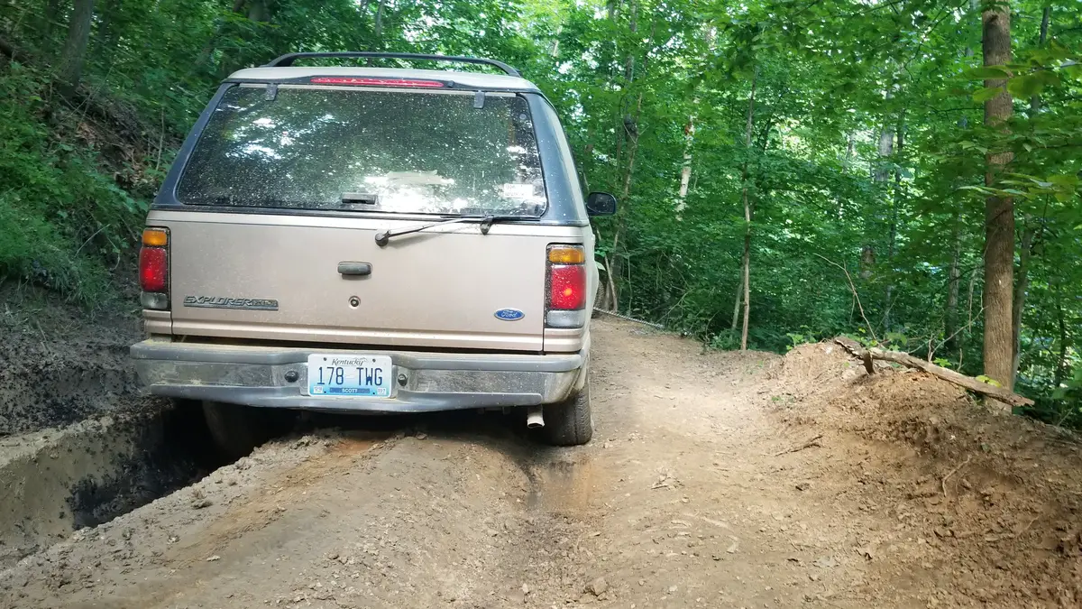

I was surprised how well the Explorer did. I used to be into rock crawling before switching to bikes and obviously thing is on street tires, is at stock height and has no lockers so its not doing anything really insane but what amazed me was the ability to overcome lack of clearance and traction with momentum and hold together time after time. Two days of running hard all day in blistering heat on Rush's 2nd highest category of trail did not phase the Explorer... That's not to say there were not occasional difficulties as you can see here.
Eventually all that fun caught up with us. An attempt to back down from a failed hill climb caused the exhaust to dig in, fold around and impale the tire through the back and out the front. Worse still the spare failed in a bad rut shortly into our trip back toward the parking lot (now on the far side of the park)... We drove the explorer roughly 6 miles on a steel rim to the nearest unofficial entrance. From there we rode double on the bike to the parking lot where the other truck was parked. Fortunately the buggy we were riding with part of the day had a brother who owned a junk yard. They made us a deal on a good wheel and tire and we made a few emergency adjustments to the exhaust and managed to roll into our hotel exhausted and covered in mud at about 12:30 at night.... Just in time as I had to be at the West Virginia Toyota plant for a project the next morning at 6:30. It was a long day but we has an AWESOME time.
