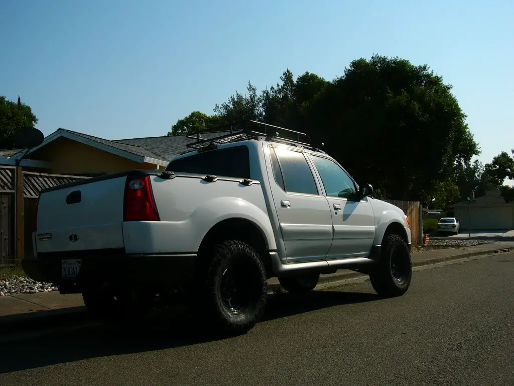

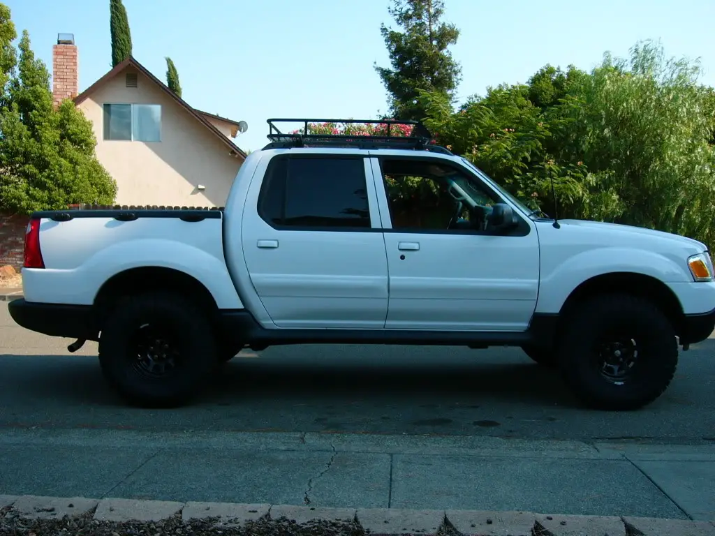

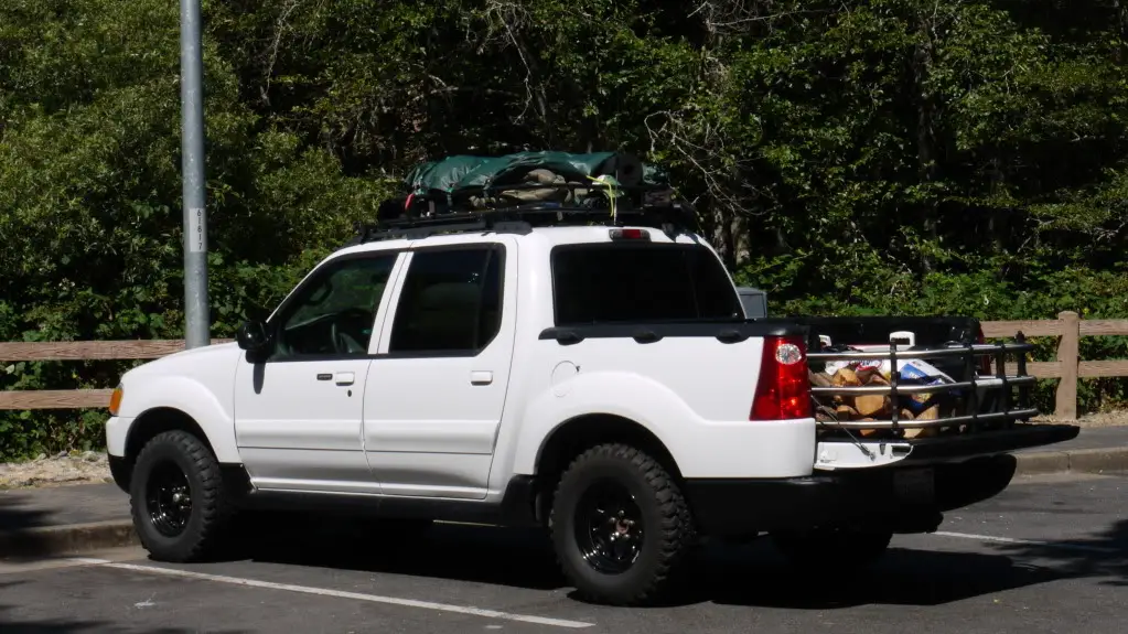

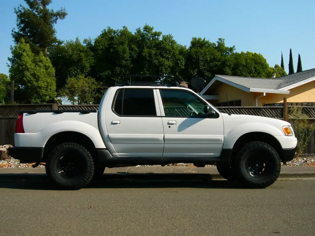

well fellas, ive been wanting to contribute to this thread since i joined the forum and here i am! i just did a TT/shackle lift with warrior 153's, and upgraded my tires from 30" pro comp muds, to 33" duratrac 33" treads. these are before and after pics. ill take better ones when i get a chance. the install write up will be up on the forum by sunday night. hope you guys dig the pictures.
here's how my ST stood at stock height with stock wheels
here's how she stood with my 30" pro comp mud tires but at stock height.
and now, here's how she stands with 33"s, TT and shackle lift.

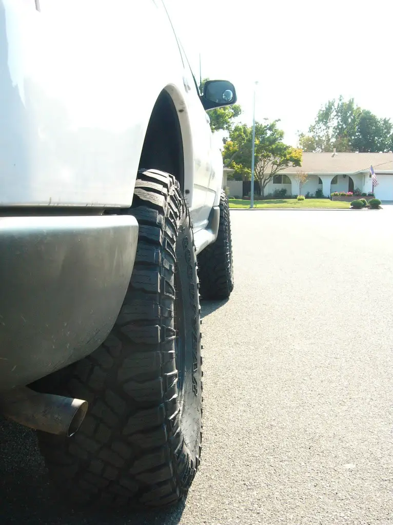

thanks fellas, ive already started trimming and my rear wheels are good to go. its the fronts where im still getting rubbing. im getting rubbing when im turning downhil like backing out of a driveway. i know where most of it is coming from because i can see where my tires are scuffing the plastic on the fender wall covers. the one place where ive noticed soem rub is on the front sway bars. its not really rubbing as hard as it is on the plastic parts, but i can notice that there's contact because i can see where the tires are touching the sway bar. any advice on that? i cant trim the sway bar, and i dont think im going to take it off either, that would seem unsafe. any tips?
ill post a write up on the trimming i did once i get it where i want it. thanks guys.
