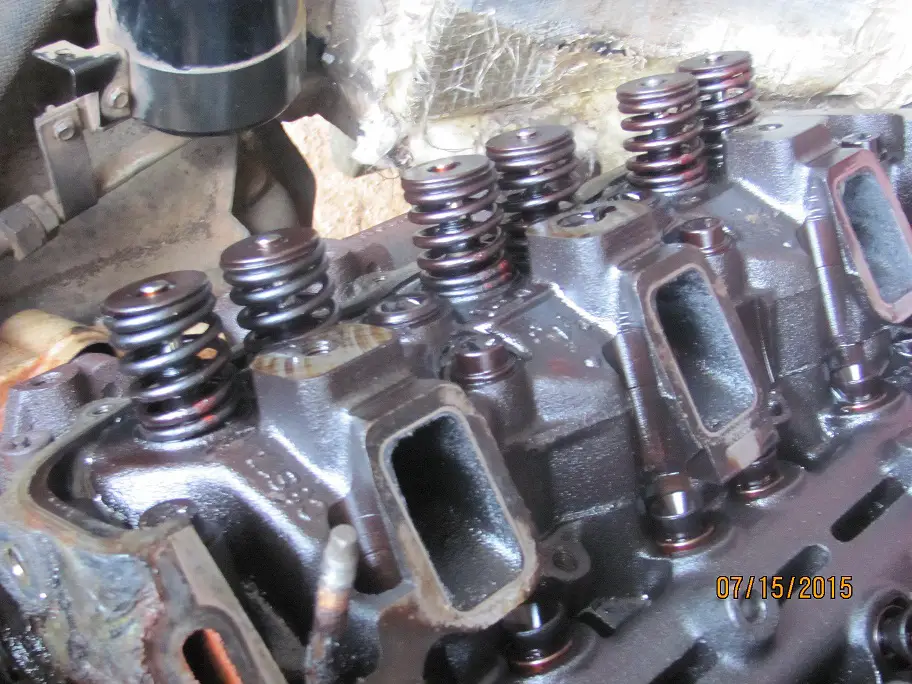

for anyone who has done the lifters - where on the head did the lifters get caught up? The post I included a link to shows the lifters 1/2 out on all valves on a 4.0 OHV engine.
You have to pull the heads to get the lifters out. I changed my lifters becuase i thought i had a bad lifter and it was a 15 dollar rocker arm. Try sea foam first before pulling the heads it might a stuck lifter.
If you can pull the lifters out without pulling the heads, something is horrible wrong. There are a vouple of lifters that the head is clearly in the way of.
With the ticking, my moneys on the rocker arm/push rods. These motors wear quite a bit more in this area than other areas. It could be a sticking lifter , but odds are better its a rocker arm and push rod issue. If the motor was running with no other issues other than the tick, its way easier to replace the puch rods and rockers to see if the tick goes away.
Replacing the lifters means pulling lower intake, and heads. This is quite a bit more work.
btw, in the thread you posted in the top of this one, he just wires the lifters up (Since he cant pull them out without pulling the heads) to get them out of the way so he can pull the cam out the front. On the ford 4.0 OHV you can not pull the lifters right out unless you pull the heads.
i just need to change the very front lifter on the drivers side 1991 4.0.its in an aerostar so i REALLY don't want to pull the head.anyone know if that one will clear the head?

Ain't no way your getting those bad boys out w/out removing the heads.
