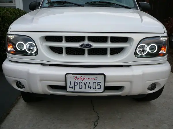

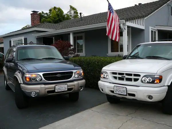

The led halos are not bright enough to be seen during the day. The ccfl halos can be clearly seen during the day. Both explorers have the halos on in this pic.
You will have to tap into the running lights to get the led halos to work. The ccfl halos are plug and play.
I took out the bulbs that light up the bar across the top of the ccfl headlight.
The 194 bulbs aren't as bright as the ccfl so it looked odd and it also looked too busy with so much going on.
