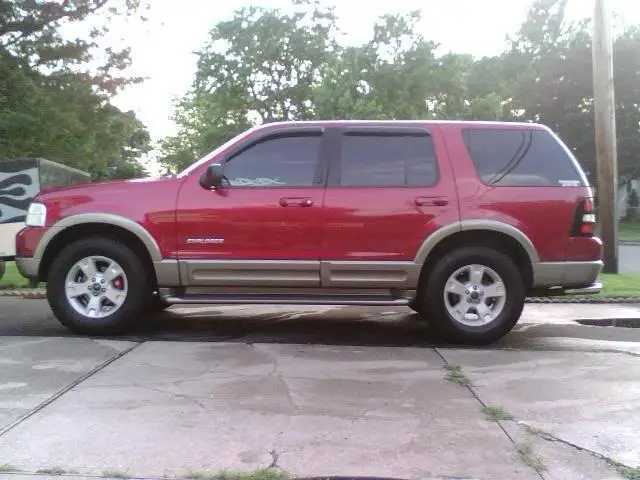

Here's the picture from the link...a non-offroading picture of 265/70's on a 04 EB:
The pics you posted are on 17in rims. Would that make a diff. or is a 265 a 265? I too want to go up in size but I have 255/70 16 right now. Shawn I will put up a pic of them when I get home. The only thing about that tire is it only that I can find comes all season tires. I want AT tires so I will probably go to 265s.
STU
17 in rims do make a difference. If you have 16" wheels, you would just increase the aspect ratio. For some reason thought the factory 17" wheels look a lot bigger than the factory 16" wheels on these trucks. Still looking.

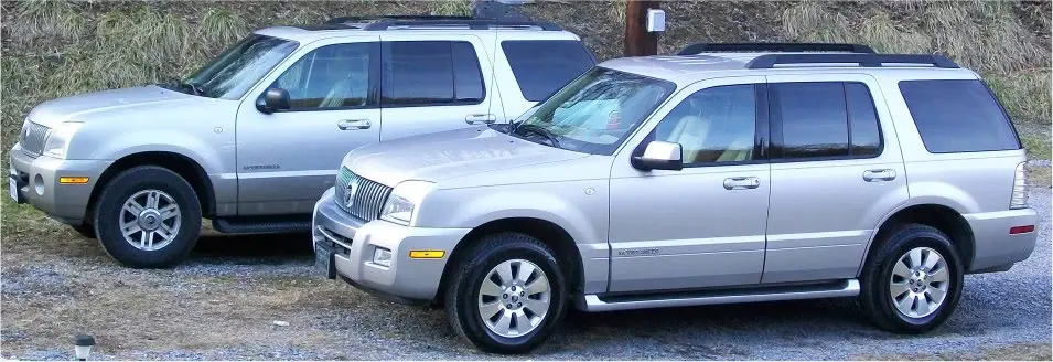

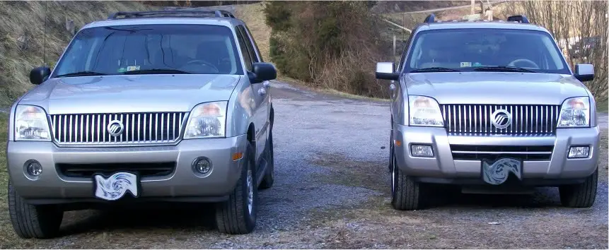

What I am saying is a 265 on a 16 the same height as a 265 on a 17. Sorry thought I would clarify that. But here is couple pics of my Mountys. The one in the back is my 02 with the 255/70s and the 2008 in the front is hers with factory size on 17s I am not sure the size. But the 08 will get bigger rubber when it is ready. Look at the diff in the fender gap and I put up the front pic to show the width diff. Gives it alot wider looking stance and sticks to the road really well too.
