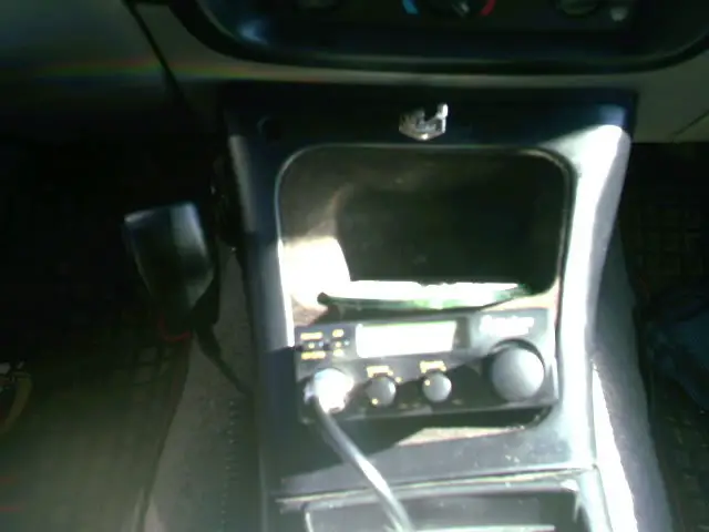

We have a 95 and 96 explorer with that "2wd/4auto/4low" control trac system. I really don't like the 4auto when trying to climb something so I had done the Brown-Wire-Mod and I love it! It wasn't hard to do, depending on where you want to mount a switch I just unbolted the driver seats, pulled some carpet, routed wire up to the center console and run a hot wire drill and hole and that was pretty much it, not very hard to do. Here is a pic of where I had mounted a threeway toggle incase you would happen to get a 2nd gen explorer and would want to do the BWM.
