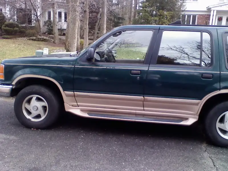

First off, when we test drove it, we couldnt get low range to engage, 4x4 worked fine, but Nothing happend with low. How do you get low to come on?
Also, their seems to be an oil leak at the back left of the motor dripping onto the exhaust manifold (well not dripping but their is a clump of black sludge) if it is oil, where is it coming from exactly?
here's what we are looking to pick up for about 1500
Ah we never tried neutral, will try next time we go back.
Im assuming its an oil leak as it is black, if we end up with this truck ill clean all that off and see what shows back up.
