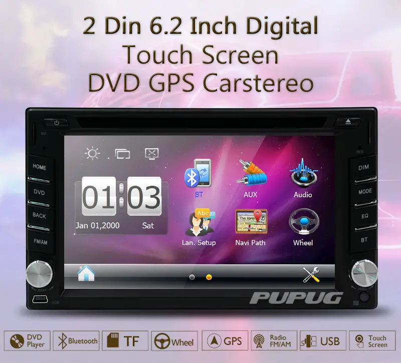

Here's some pic's and a web site selling the stereo Id like to get. Anyone here have one or a similar one in there truck? Also what if any problems can I expect to have installing this stereo? I have the original cassette player in there now and the cassette player eats tapes :(. I mostly like the gps feature on these stereo's. . Thanks!
Camera New 6.2inch 2din car audio Wince GPS Navigation Bluetooth car dvd player in dash FM AM RDS USB car radio Aux multimedia -in Car Multimedia Player from Automobiles & Motorcycles on Aliexpress.com | Alibaba Group
You’ll have to slightly modify the surround to fit a true double DIN deck in its place. Installation should be straight forward.
However, with that junky deck, I’d expect the longevity to be weak, and the navigation to be garbage. There are a few cheaper decks that are decent, but as the saying goes “you get what you pay for”.
The item linked to in your post has a Windows CE operating system. You'd be better off with and Android unit. Lots more apps could be loaded. I'm thinking of adding a tablet (old Nexus 7) or cheap double DIN android device to my 1995 Sport.
