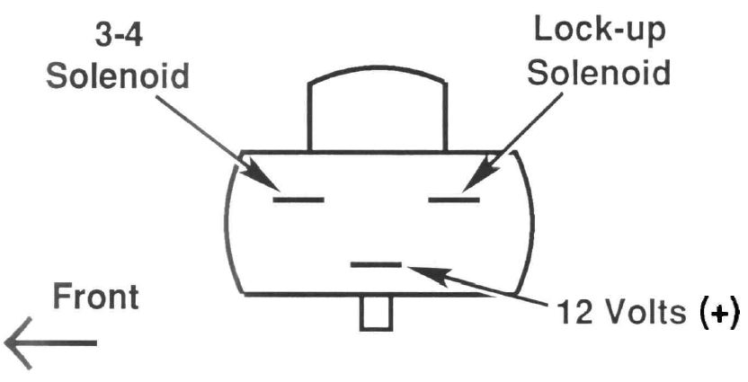

Your 94 should have a A4LD transmission, and there is a case connector on the driver side that has three offset pins like that harness.
This connecton is for 4th gear and TCC for the transmission, it wont be the reason for the vehicle shutting off.

Looks like you may have found where this goes.
lockup solenoid can kill the engine by locking up when it shouldn't...
This is true, the lock up solenoid if clogged or stuck on can cause the engine to stall when selecting a gear, however the case connector being disconnected won't cause the solenoid to close.
