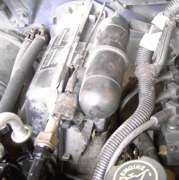

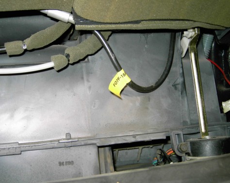

Finally, I had a thread last year trying to figure out what a lozenge shaped part was. See attachment1. Well it's a vacuum reservoir for a vacuum motor behind the glove box. The motor controls the outside/recirc air door (attachment2). Whenver the A/C is in max the motor engages and closes the door. I guess the rest of the time it's always open.
