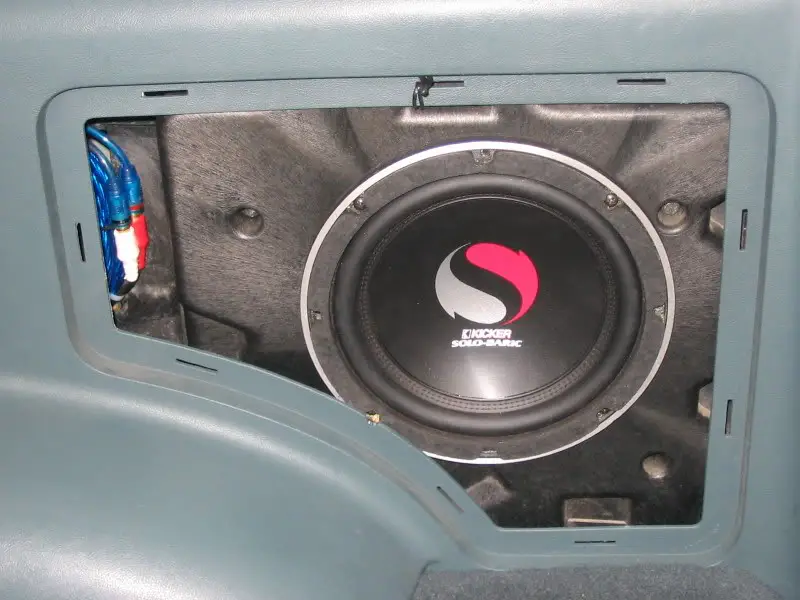

Today I was on a mission to silence my stock subwoofer, When I bought my mountaineer a few weeks ago I didn't realize it even had a subwoofer but after driving around I located it and also realized it was blown.
So I wanted to eliminate the stupid cracking sound so that I could have my nice...crappy stock speakrs :p:
So I went to work pulling off the plastic peice that covers the sub (what a PITA) I then took all the screws out of the subwoofer and realized...I couldn't take it out..I'm guessing theres something else holding it in from the back? either way I just wanted to make it stop working so I didn't have to hear the crappy noise in the back.
I cut the wires going to the sub and in doing so I remembered that I had a couple subwoofers laying around I bought for about $10 a piece during a discount sale. They were CHEAP.
I wasn't sure if it would even work out so I got some wire and my subs and hooked it up and wala... cheap crappy bass. BUT it sounded 10x better than the blown stock one. I found an old box laying around and just put it all together. Should work til I get up the $ for my system.
I've since then properly done the wires (not with duct tape ha) and put the sub behind the drivers seat to make believe its better than it is :rolleyes:

what size is that sub? I'm assuming you're running an aftermarket amp, where did you put it?
I was looking into doing that, but I was going to build my own box
That is my "Budget Bass" setup.
Kicker Solobaric 8" 2ohm
Amp is under the rear seat on the driver's side.

nice work, simple work to keep costs simple.....theres actually a small amp right behind the molding that you can't see, and its a pain to access. I always wanted to know how strong it was.....
Click on image for larger view:
I like that setup, I have to ask...how hard is it to pull off that side panel? Just the speaker grill itself was a pain.
I was told it was about 100amps. Not enough to push much of anything, (except my cheapo subs) If I blow it.. I haven't lost anything. Plus I don't see much use for it for anything else
no its not too hard. just 6 or so plastic pins and a few screws. the only "difficult" part is the seat belt bolt. but you should be able to use a very large allen wrench. (assuming first and second gens still use the same bolt)
