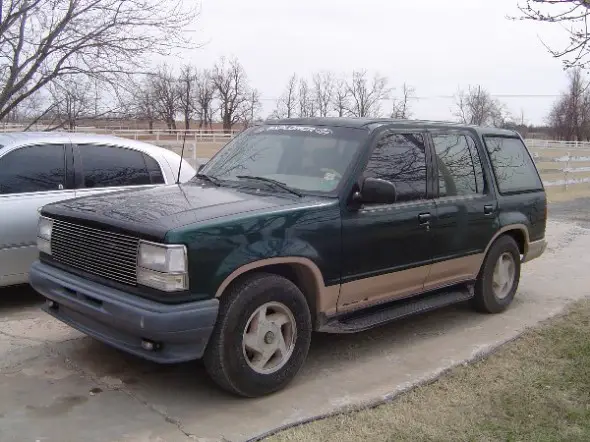

yes all you can do is a 2'' drop due to the front diffy hittign the oil pan if it was any lower. They make drop coils for the front and you can use 2'' blocks in the back. Let me find a pic

NICE59FORDF100's truck - Its still under construction as he got it as basically a beater. I think when he gets it repainted with soem nice wheels and tires it will look REALLY good!
