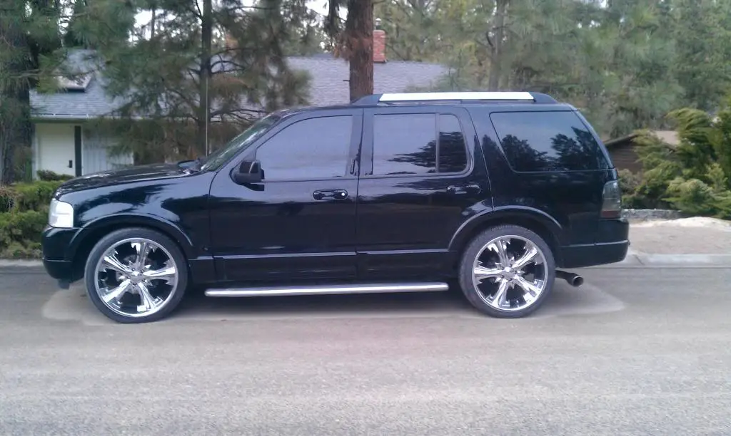

Does anybody have pics of how the ground force springs drop look on an ex on 22s?
That would be an incredibly snug fit. Almost gauranteed rub issues on the front. With my stock wheels i cant stick three fingers between the top of the wheel and the fender.
Ask and you shall receive
265/35 22x9.5 Voodo 407's No rubbing ever.
It had just rained and it's a phone pic but gives you a good idea.
265/35 22x10 Voodo 407's No rubbing ever.
Thanks man looks amazing!
Whats the back spacing on those 22's? I am planning on running a 20x10 and was worried about rub upfront, so its nice to hear that even you dont have rub. I have to say those 22's still have a lot of rubber left on them, looks really good.
Whats the back spacing on those 22's? I am planning on running a 20x10 and was worried about rub upfront, so its nice to hear that even you dont have rub. I have to say those 22's still have a lot of rubber still left, looks really good.
Re-checked, they are a 9.5 and a 40mm offset.
Sorry for the mix-up.
