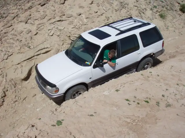

Mine (35"s, d44/9" full spool rear, locked front)
I usually hit them pretty hard on this obstacle...or it's the rear end...something hits hard when i get it

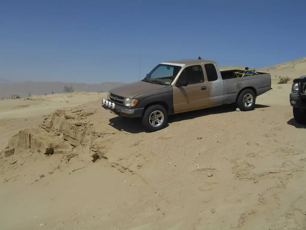

PS. My yota was 2wd with 205/75 15 street tires. It went alot of places. The other pic is my merc stock. It had a factory limted slip and was AWD (no low range) It went everywhere my buddy's lifted cherokee went.
